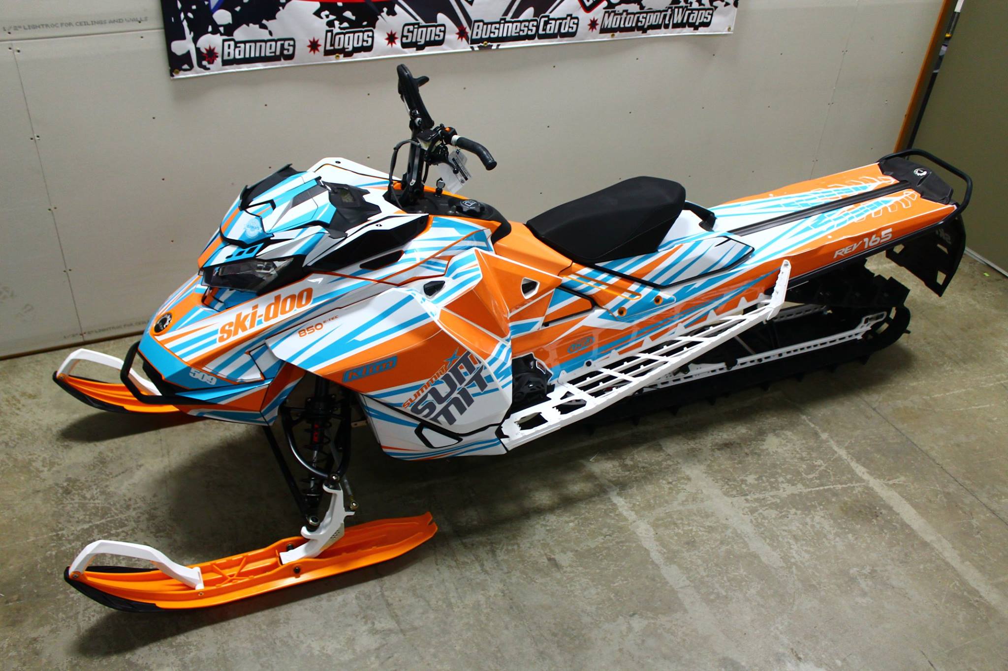

We use the X1 for our dirt bike & snowmobile "wraps". Which really they are pre-cut pieces that looks like a full wrap. With the air-escape vinyl they only want you to apply it dry. I take it you are using the Ultracurve 1000 or 1500 lam.? Its pretty thick laminate to be actually trying to fully wrap a ATV. We hand template our sleds wrap to the contour of the body. Its really the only way to wrap a dirtbike or atv with low energy plastic and having to use a sticky vinyl to make sure it holds. The vinyl can be heated and stretched a little bit but in con caved areas It probably won't hold the best.
