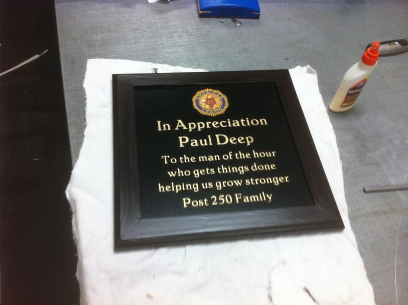

small award plaque, sandblasted granite tile with.... testors met gold model paint! If I had a large amount to do I would go another route but I was pleasantly surprised with the result. More importantly so was the customer.

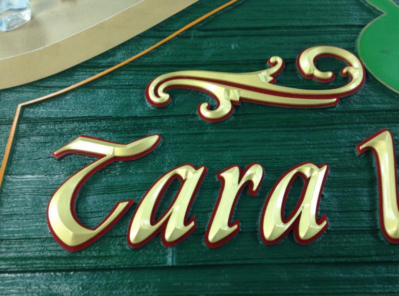

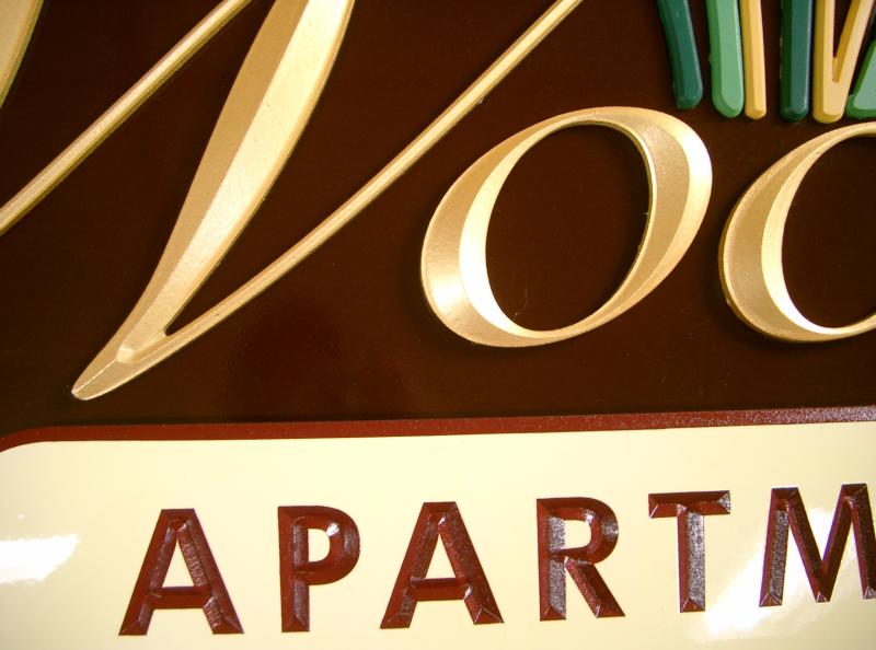

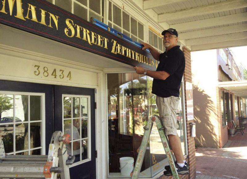

Matthews Brilliant Gold metallic. Forgot to mention, it needs to be clear coated with their UV satin or gloss.
