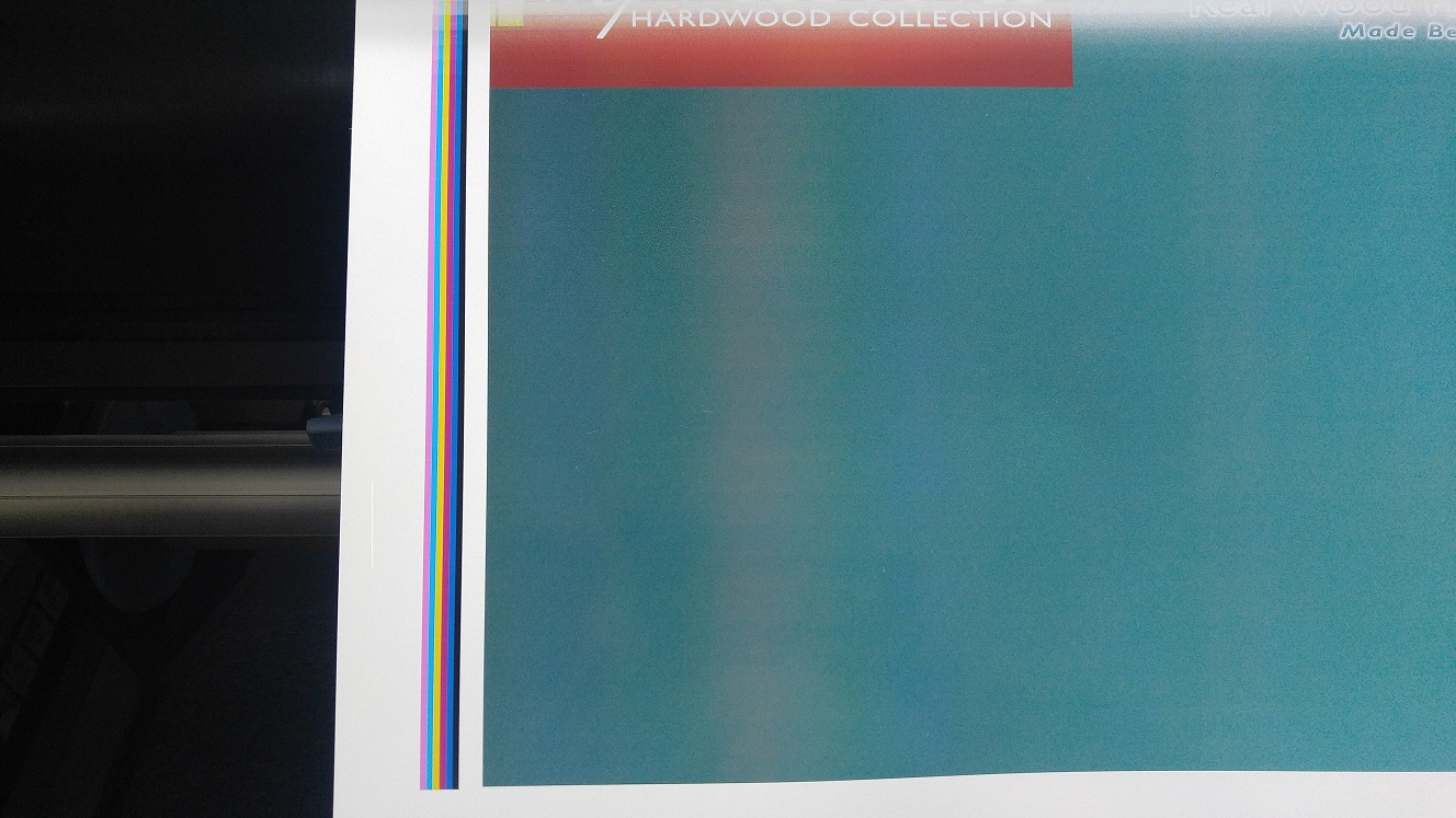

This was a print from our first use of 1105. Our rep. Sent us a new roll and it was fine. They took that print but never said what could have been the issue. We also got the ( we never heard of that happening) thing to. It was nice to install but we have returned to the 3M just because we never had a print issue with it. Print was on a Seiko W-64.
What profile and rip system?
