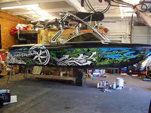

Come on down to the dozens of local boatyards in my neighborhood. You will see many scissor jacks in use.
I am willing to bet that if you have a collection of sign mags that cover boat wraps you will see the wrap shops using them as well in a pic or two. It's very common.
Common sense should always be applied.
I do not advocate using old milk crates like in the pic here. I prefer large Styrofoam blocks.

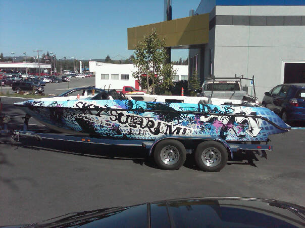

we used a forklift with foam along the forks to lift this 24 footer
