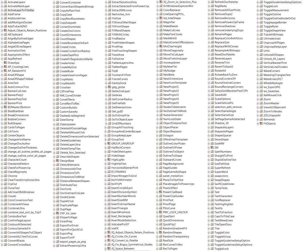

Just a little list of some of my Corel X7 Macros. Some are tests that I never finished or just testing code.

I think I saw somewhere on your list something along the lines of quickdimensions? Is that something that can be purchased?
I've spent so much time sending proofs with tons of specs and dimensions over the last month and absolutely hate the coreldraw dimension tool settings. (You'd think I'd get faster/better at using it, but no, just more annoyed)
myront
CorelDRAW is best
I assigned the letter d to QuickDimensions macro. Select a shape then hit d. You'll have to set your defaults as you like them to be. Another thing to keep in mind is that these dimensions aren't "married" to the shape (I forget the proper terminology). That means when you resize a shape afterward you'll have to adjust them manually.
