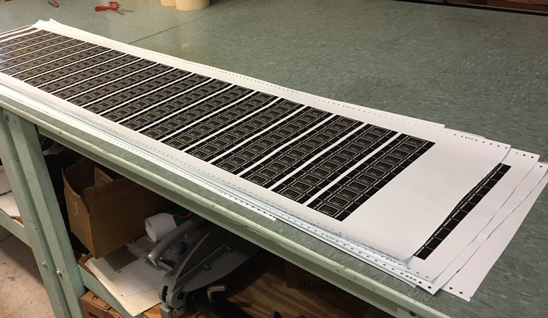

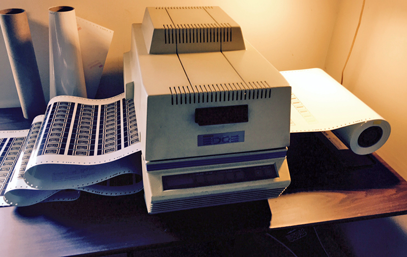

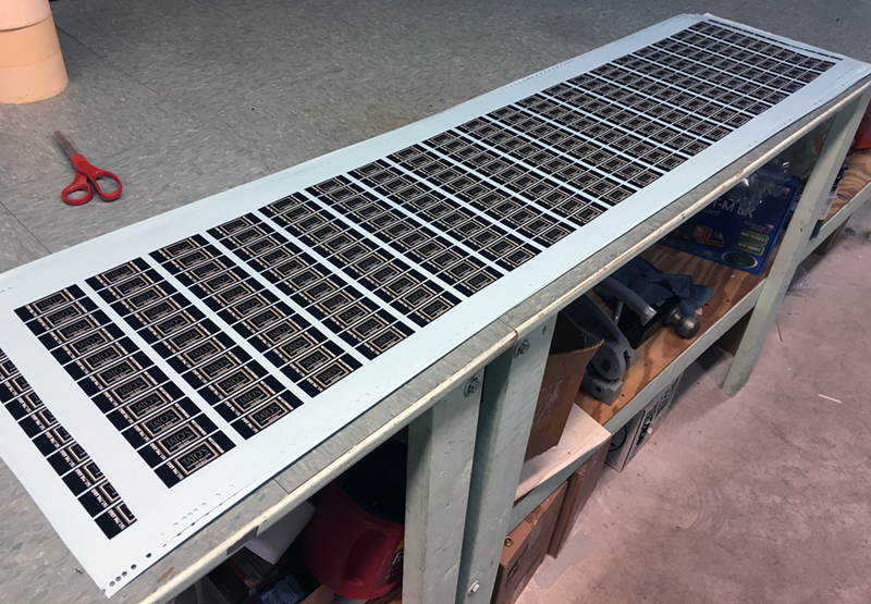

Printing is done is two passes, one for each spot color, 5 feet at a time which yields 220 labels per print run. Limiting the length of a run keeps handling easier and also results in better color to color registration.

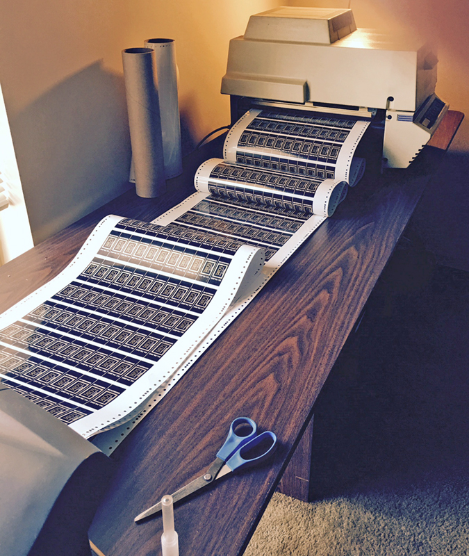

Our plotter sits at the opposite end of a 6 foot table. We feed the completed prints into it directly so that we can print and cut at the same time.
Once the printing and cutting is done, they are moved to our weeding and finishing area.
After weeding off the unprinted vinyl, we're ready to trim out the labels into single vertical strips.

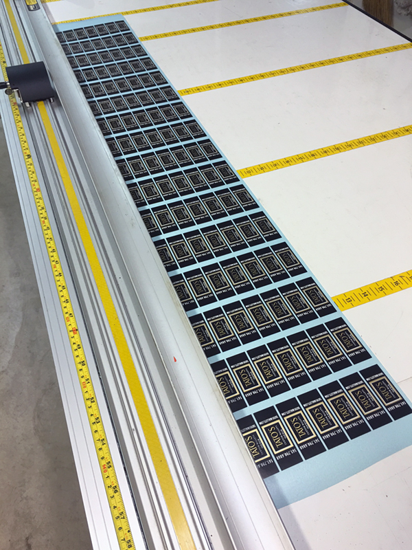

First the excess release liner is trimmed off the top and bottom of each section on our Keen Cutter setup.

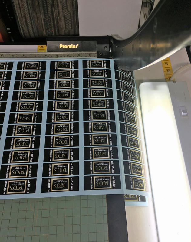

Next the sections are cut down to single vertical strips on our guillotine cutter. The use of a low profile fluorescent light allows the blade edge to be seen through the release liner to avoid bad cuts and get done faster.

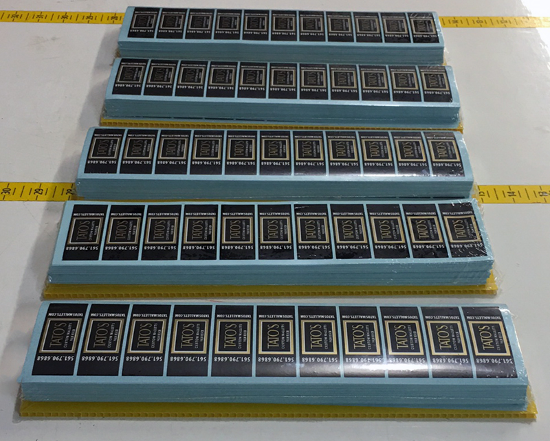

The trimmed out labels are sorted into stacks of 1,000 labels and finally shrunk wrapped to protect them and create a quality impression for the client.
