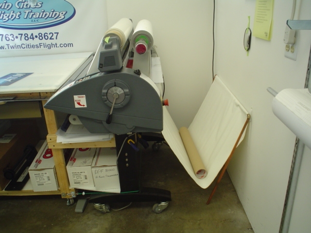

Okay so I've had the daige quickmount for about a year now. It was a rough start to say the least. But I've pretty much got the thing figured out now. My only problem is I wish it had a take up reel or someway to deal with the output vinyl after its been laminated. DOES anyone have this laminator and has figured out a great solution? OR any solution for any laminator??
Thanks

I just made a catch basket out of banner stock and copper pipe and fittings
that keeps the vinyl off the floor and swings out of the way if I need access
to web the laminator. It works for me. When I am done laminating I cut off
and pull the laminated vinyl over the top of the laminator onto the 11' table
that feeds the laminator and do what ever cutting/finishing required.
AKSigns
Great thats what I thought I might do, but I wasn't sure if it would work!!! Thanks for taking the time to show me it!!
