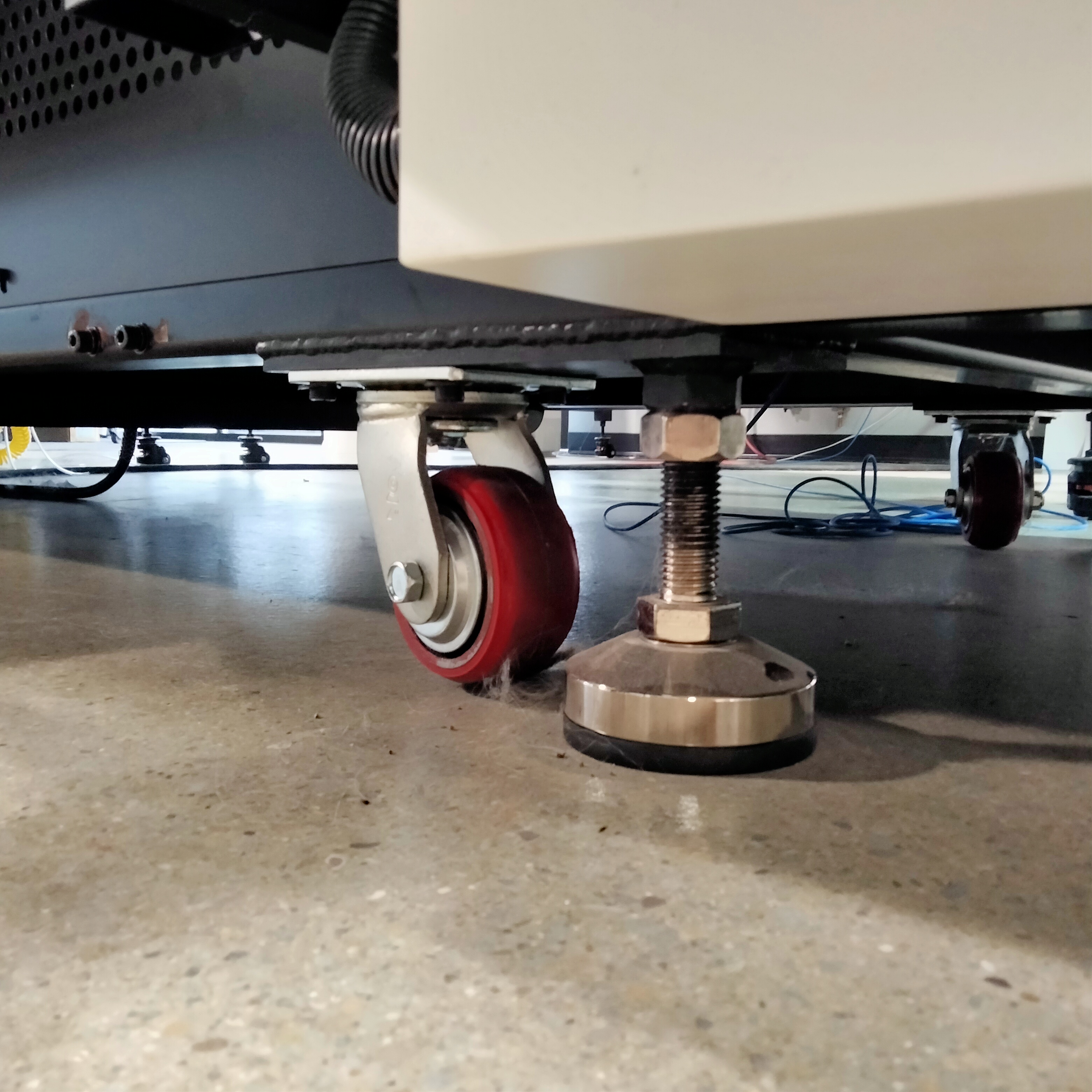

This is what we have under our Annapurna
