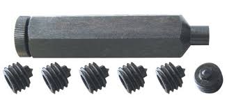

I was a tool and die maker in another life and I like to use transfer screws like the ones shown here. They thread into the holes and allow you to get the letters within 1/16" of the paper before you press them into the pattern.
JB
James Burke
so basically a short sharpened stud :thumb:
Correct, but they're precision machined to be very accurate...so long as you use the correct tap drill size and there isn't a lot of clearance (slop) between the screw and the hole.
We do a lot of bronze plaque mounting and they work exceptionally well for that purpose also.
The holder tube doubles as an installation tool to insert and remove the screws from the threaded holes.
They're also available non-threaded.
