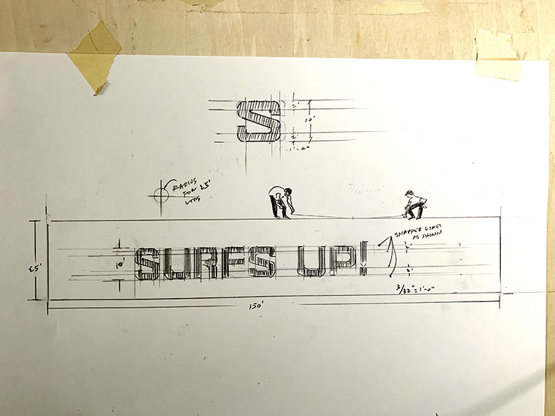

could you hire a sign painter in your area that can lay it out for you? sure beats patterns or banners or any of that. I have done a few of these by chalking it out with great success
Johnny Best
Agree with old timer, this job is easy, no hanging off walls, a good layout to scale, couple boxes of chalk a 2" cut in brush and wham your done. Old Timer and myself will knock that sucker out in a morning. Did one to scale, 5 minutes.

If you can make the company logo big on a paper pattern then you can make it on the roof, no pouncing and messing with paper blowing all over the place, tape and a pounce bag. A good scaled sketch like mentioned and draw it out.

Nobody has told how they would mark the grid on the roof membrane, and make sure that it's square, etc. without damaging the roof.

actually a few people did, and even drew a sketch....it may not take a few minutes, depending on complexity it may take a day or two. Charge accordingly.
And squaring up something on a commercial roof is very simple, and chalk lines and or whatever is used to fill in won't hurt a roof that can take walking on.

I guess what I'm saying is I know how to chalk lines, and so on, but you're going to have to make a grid on that 25x150 of what, 5' squares? I've seen it done where you drive a nail in the corner and measure and so on to make the square. But you can't nail on the roof. So how do you get the initial square marked by yourself and know that it's actually square? Or do you just get it close and figure nobody will be able to tell?

without seeing the actual artwork i can guess it would probably be with a few sheets of coroplast, a box of stabilo's, some string, a grid layout that was based on whatever pattern already existed on the roof. i can assume the roof isn't one piece, so i would use the natural lines on the roof incorporated into the artwork to give me scale. it's not rocket science, any signguy should know how do do this.

2 people, measure off the edge of the roof to get a horizontal and vertical starting point. Create the rectangle border, you can measure corner to corner to make sure it's square if you want to double check. Then snap your grid. Grids size depends on complexity. Then have a large version of the design on a hard panel, again size depending on complexity and cut it up into manageable panels if needed.

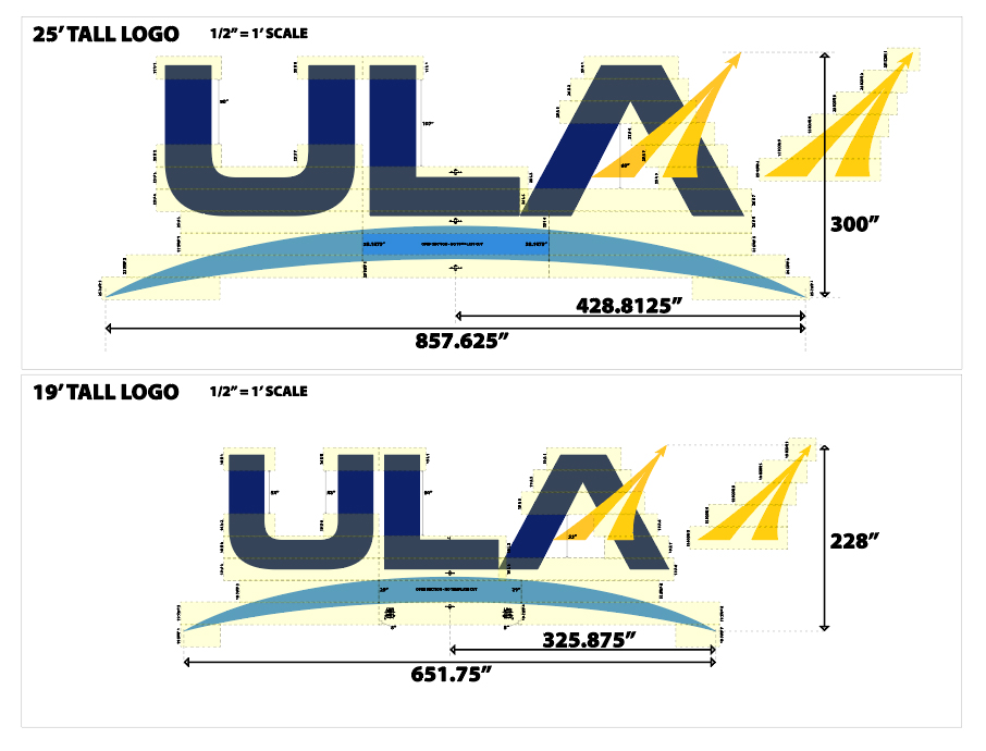

We are bidding on a project that will display a client's logo and website, all one color,(black) on a huge flat roof of a brand new building. They client is near the airport so they are proposing this to be approximately 25' tall x 150' wide. It scales pretty close to that. The text alone is over 10' tall. We are bidding on just making the stencil, the roofing contractor is doing the painting as they have a special paint made just for that particular roof substrate. Totally fine by me. Now to the big question, how do we go about applying/making the stencil? I had thought about make it reverse cut out of removable vinyl but it would be a major pain with so much area removed from the vinyl to lay that flat and install it. Also, though about having stencils made out of .020 styrene panels. Or, having a good artist go up there and lay it all out and tape it off. The painters want it ready to go, and just have them roll the paint on. Suggestions and ideas for this? The pricing is difficult on this as well but I'm thinking at least 10k.
In the past I've used the backing from the laminator roll and plotted it out on the plotter. Since it's that big, I would use the pen, not the blade, and cut it out by hand. I'm sure there's a better idea, but if this gets the thought process started towards that idea, that's better than nothing. :p

You can use the 3-4-5 rule to check for a right angle in the corner and layout the grid from there.
