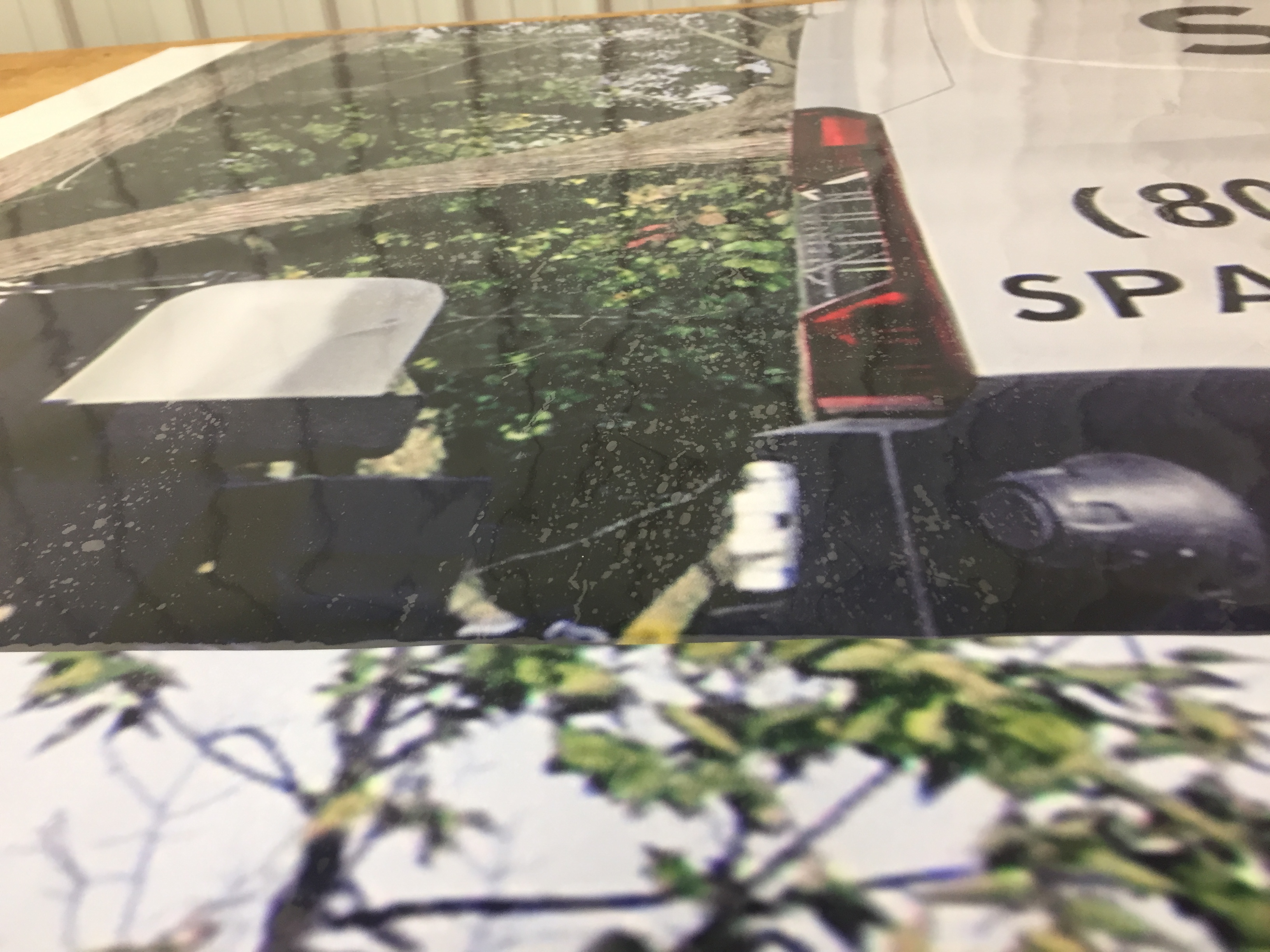

Here is a photo.
Ive rethreaded the material a few times with the same results. I can not add more pressure as it just uses the weight of the roller.
With the roller all the way lowered, I also ran it really slow without any material loaded and checked for gaps in the 2 rollers. I did not see any light coming through.

was this with in your 30" area of the stuff you normally run, was it outside that area?
if you run a set size for a while your rollers will change size with in that are then when you try to run something bigger it can give you issues.
Rat_Fink
It was within the 30" center area but also out of that area. I just loaded up more 30" material, but loaded it most of the way to the right.
I still got some bubble, but not nearly as bad and most of them were toward the center of the roller.
If this is an issue with the roller due to using primarily smaller material in the center, is there any solution or is the roller just permanently damaged?
FatCat
FYI - you should always run all materials in the center of the rollers, no matter what the width. The main reason is that those rollers are usually crowned, and running it off to 1 side or the other can produce some weirdness at times. (At least in my experience.)
What are the temps like in your shop? If the rollers are very cold and the material is cold you will usually get more bubbles and silvering, especially with thicker calendared materials. We have a similar laminator (AK-600) and usually have to crank the heat up for a few hours to get the laminate warm and the rollers warm and things lay better this time of year out in our bay/warehouse where the laminator is stationed. Now that we have a new laminator with heated rollers, not so much...lol.
