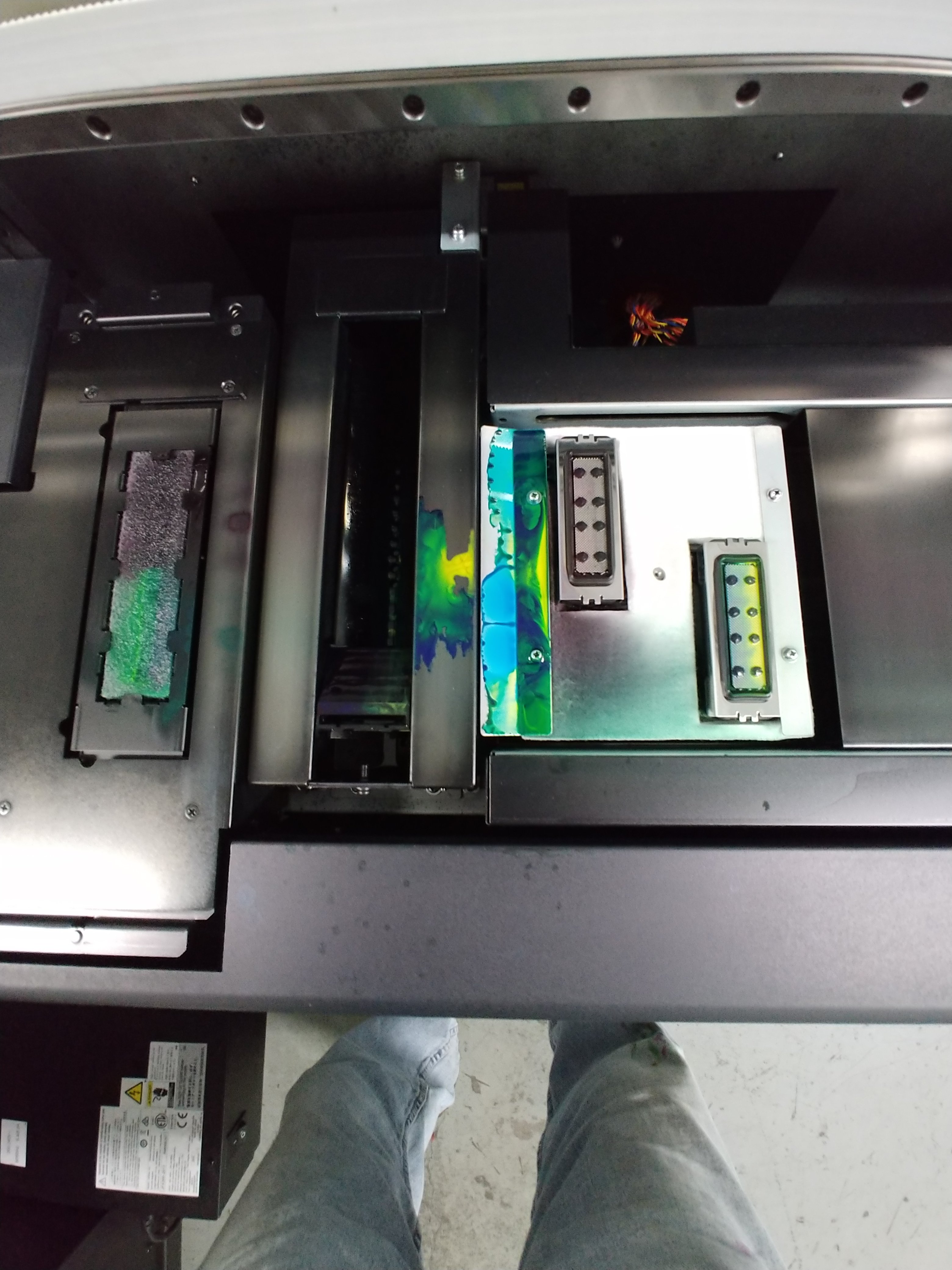

Just read this thread and thought I'd chime in about our printer which has been in service about 18 months. We started getting this supply ink error on Cyan and Yellow a few months ago when we came in each morning after the machine was shut down at 4pm the day before. I run the sub tank maintenance and fill that side and the machine is fine for about 2-3 cycles of it's powering up-refreshing-etc. Then it's the same error. We have looked for leaks with no luck. We also replaced the ink bottle caps on those colors but that didn't help. Recently when printing we are getting excess ink pooling beside the wiper blade and between the wiper blade and capping station. Would love to hear if anyone has solved this problem. The machine has been great as far as printing and is still all original parts with the exception of the 4 caps that have been replaced.

Anyone else experience this? Only when printing. I have checked the negative pressure and it is fine.

Have you tried checking or replacing the air line filters above the printhead. (On the air line going into the Subtank). If those are bad it can effect air pressure and cause leakage.

Thanks for your suggestion. I will do that and see what happens. I will need to order the filters first. I will let you know what happens. Thanks again!
