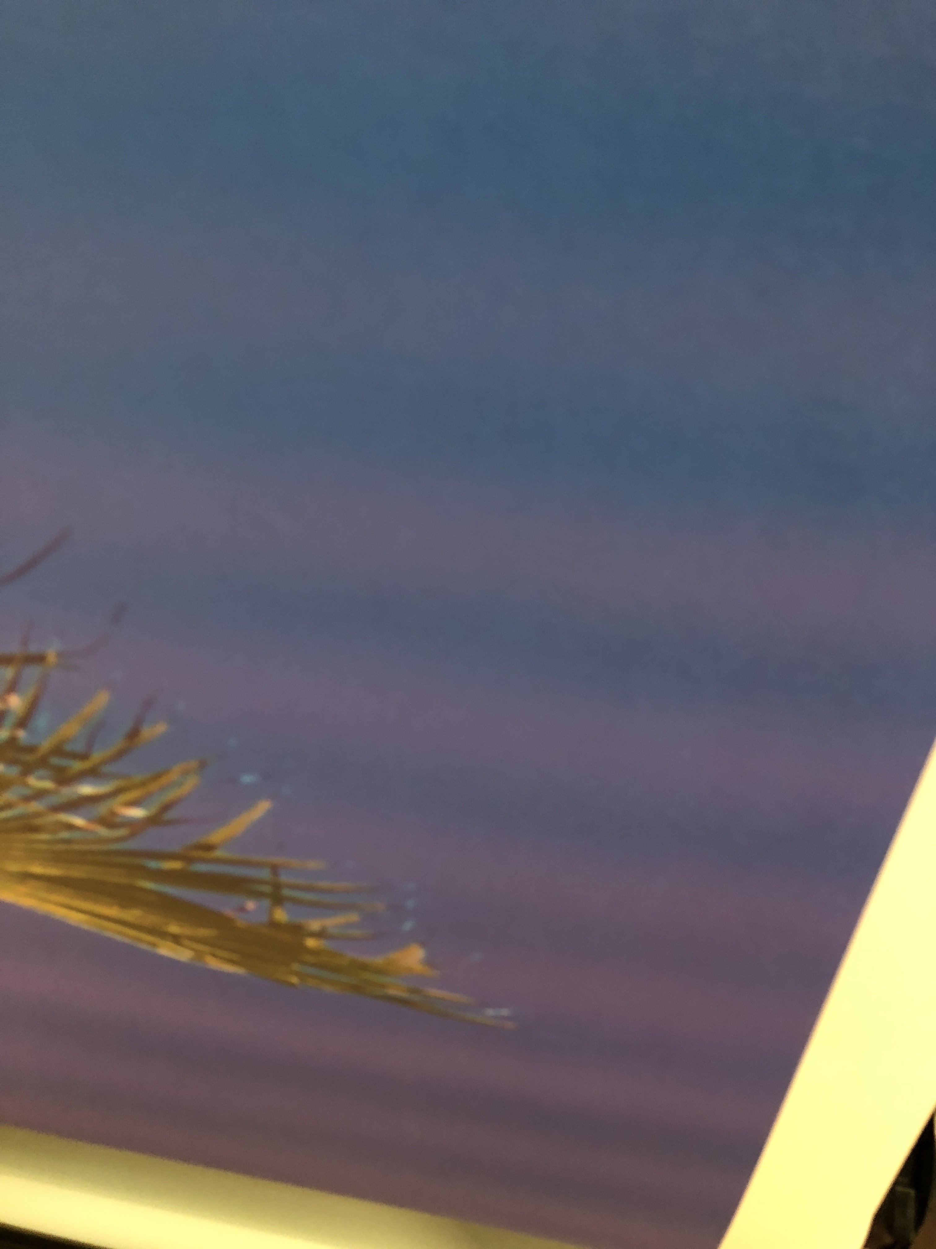

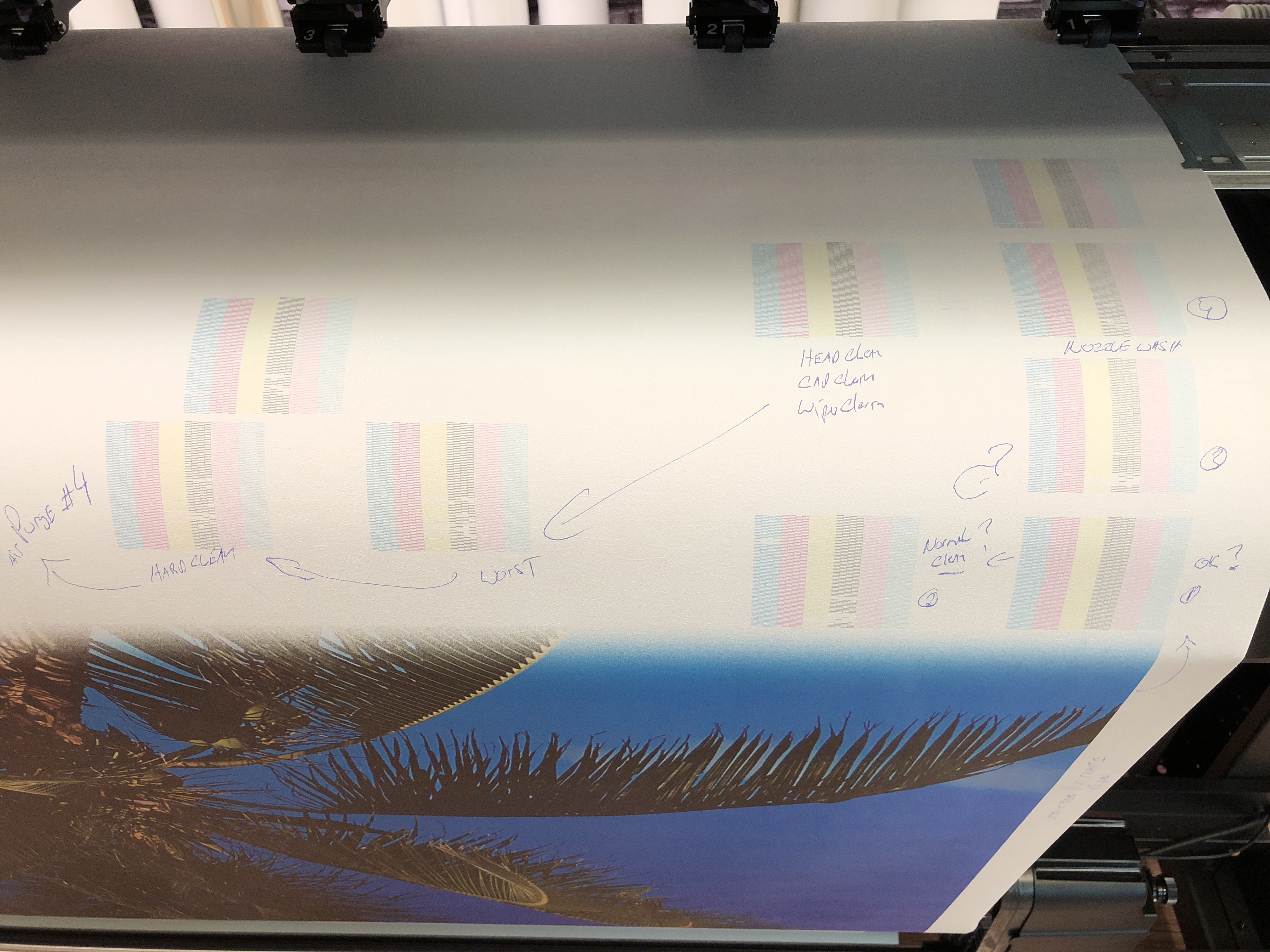

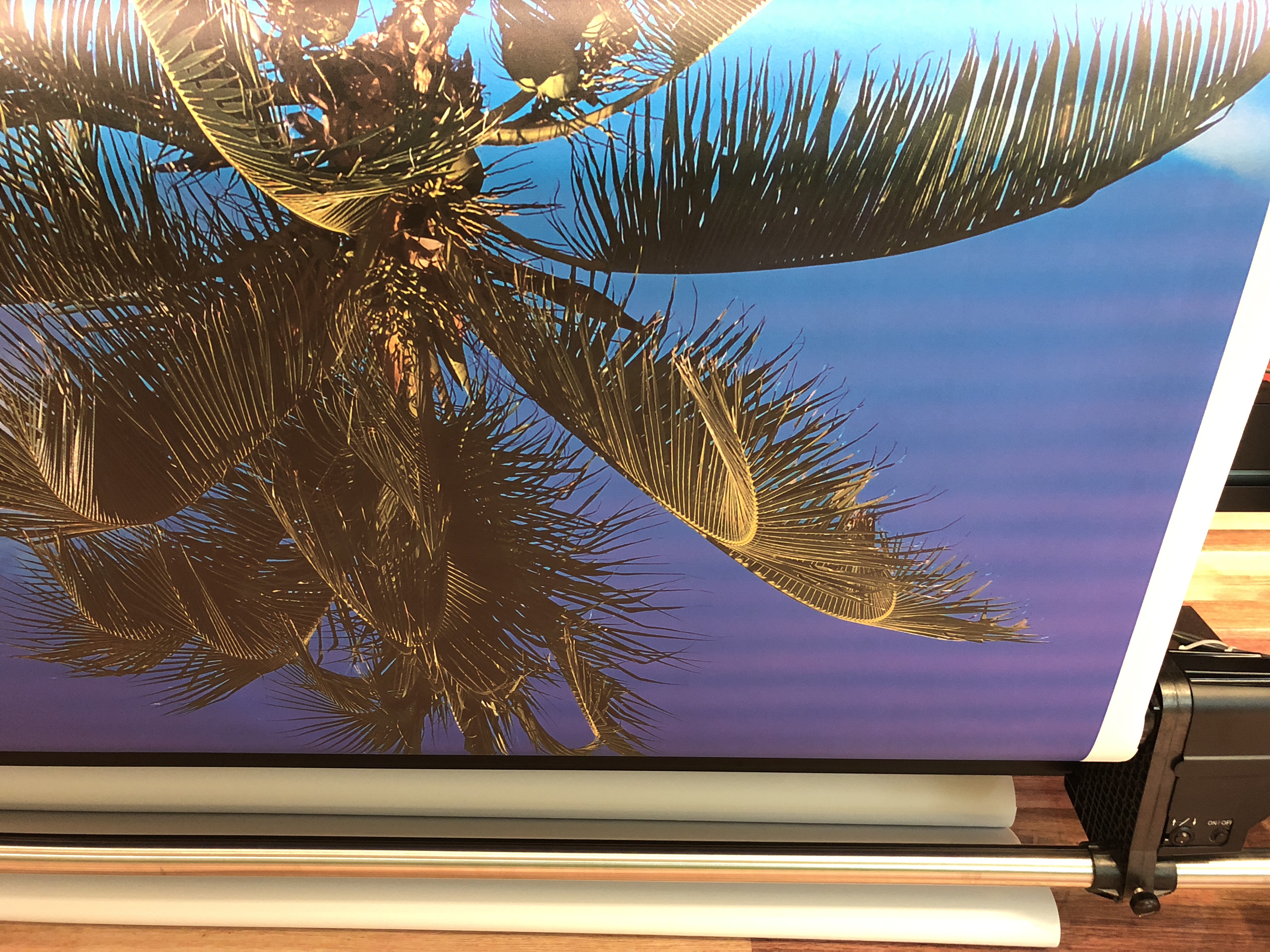

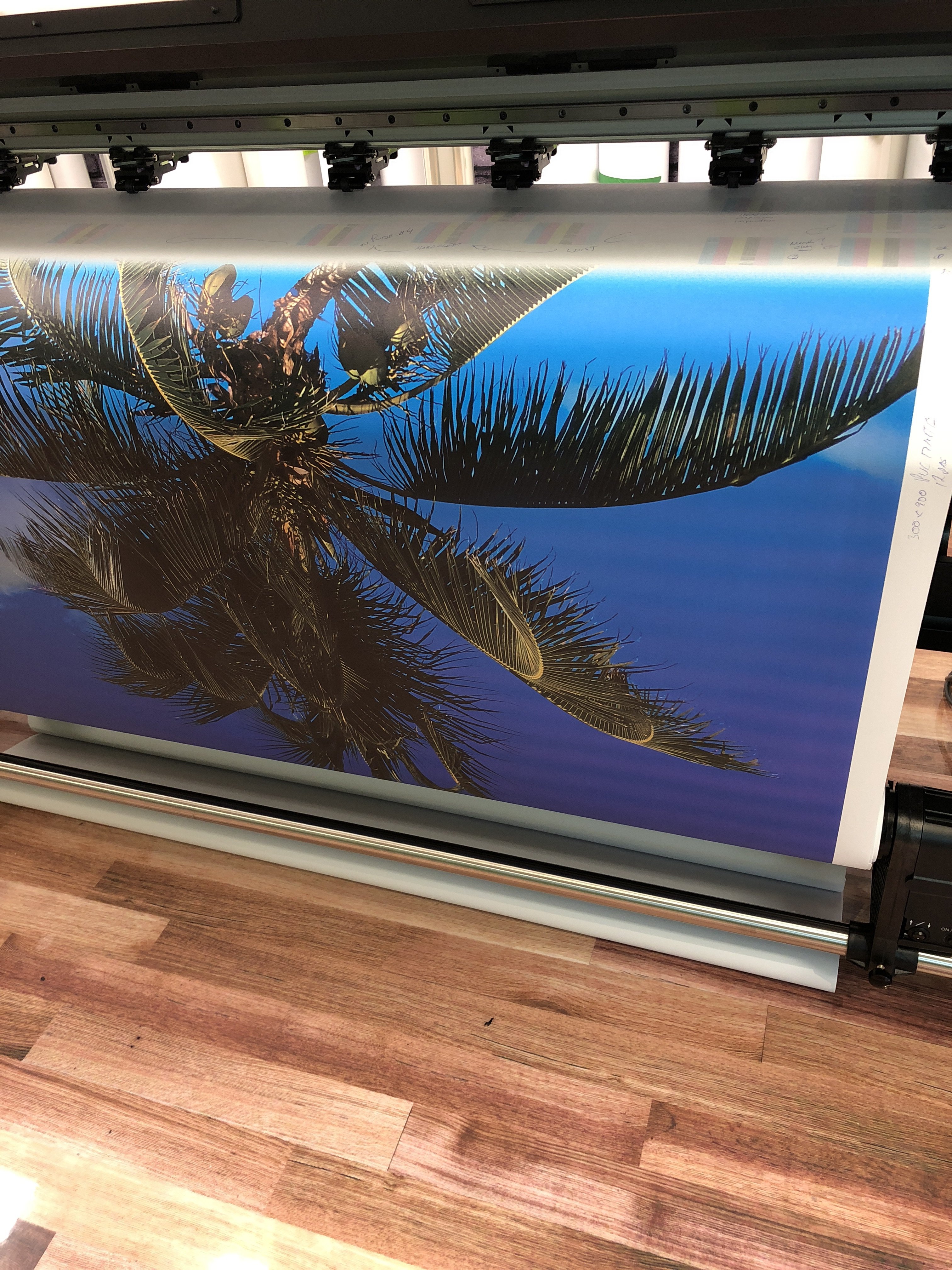

Attached you will see what I have been experiencing since day 1!

I have tried all of this, I air purged, I cleaned manually, did nozzle wash etc. etc nothing works. If you look at my picture with the test prints I indicate everything that was done before each test print. Thanks again for your reply .

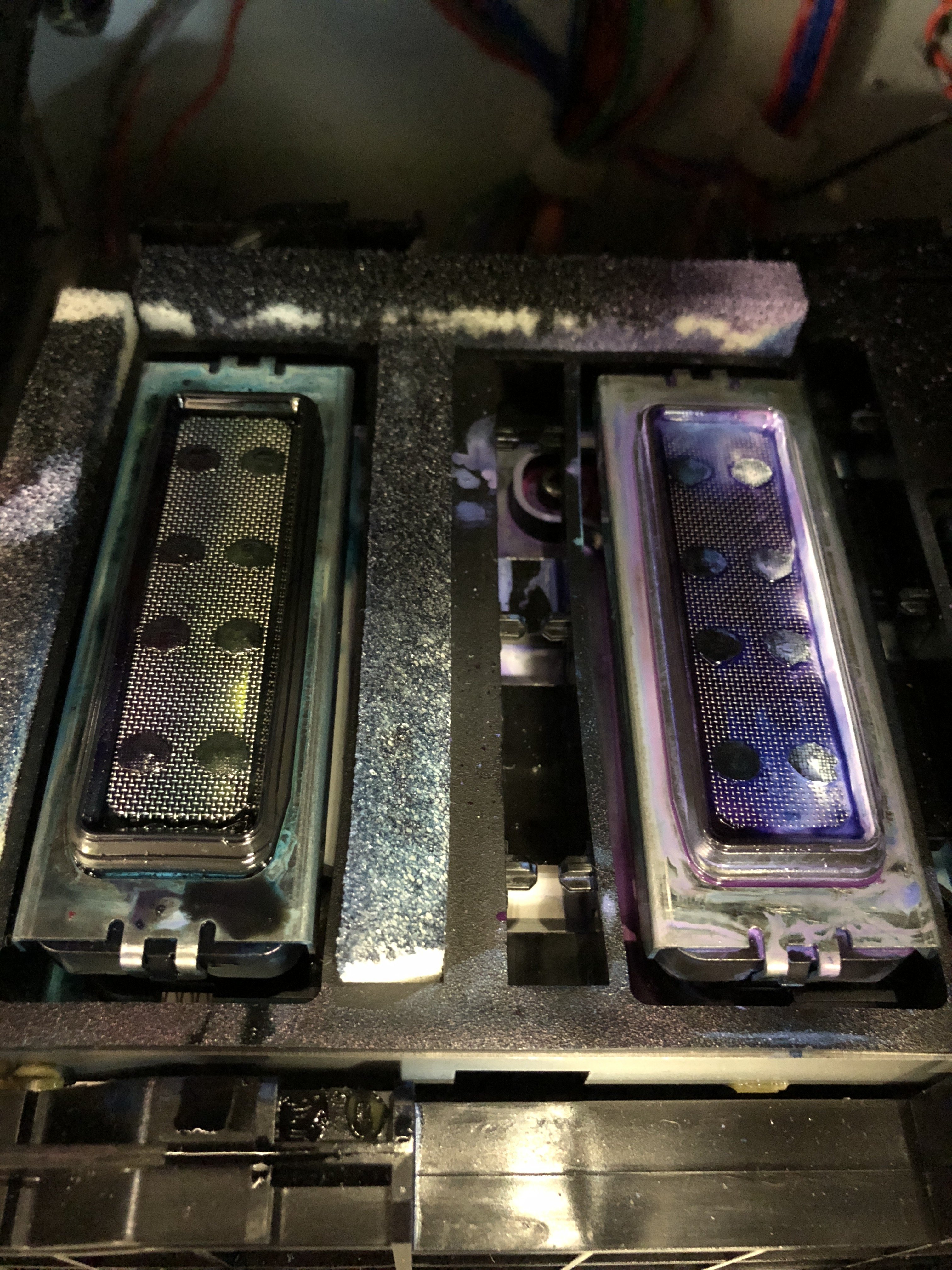

hello, the cappings are not aligned, or too far, it was mine too.
if the cappings are not parallel to the head print, mine were obliquemust, behind almost touching, in front were 3 mm low
adjust the '' Station Height Adjustment '' mechanical adjustment by means of screws
there are 4 screws, 3 are to be adjusted, one is fixed on the back left, the other 3 screws should keep a distance as close as possible to 5 mm from the floor, so they must be adjusted accordingly bring the station capping parallel to the head print, then the centerings must be adjusted with the fork, and the distances(3 capping positions)
there are 3 capping positions (regulation via service menu)
[HASHTAG]#CAPPING[/HASHTAG]
Empty suction 0,5 mm
FLUSHING POS 1mm
PURGE POS. 0.5 mm
if these distances are not correct, while printing the sprays dirty the cappings, mine were all over 5mm
for safety I was further than 0.5 mm and the situation has improved considerably
Then......., air spurge or fill ink, deep manual cleaning, that crap around the capping does not have to be there, and perfectly dry the capping rubber perimeter, 2-3 disway wash, 1-2 heand nozzle, other manual cleaning and all will work

Well good news! Mark Noden from mimaki Canada spent 3 days working on our machine and finally found the problem before calling it quits. Turns out the feed belt was slipping causing feed instability every time we tried to print at lower passes and higher speed. The issue is finally resolved. Thanks to Mark, our dealer All graphics supplies and Mimaki for all there help. I would strongly suggest anyone who has this issue to contact Mimaki as they are now fully aware of the cause and fix for this issue. We will be running our UCJV for a few weeks and if all goes well order the second one. Still no news as to why the white ink smears off with water but they will get back to me with information after testing. As for the nozzles dropping during print that had something to do with proper capping adjustment and a few other fine tuning details that needed to be addressed. Just happy to be printing, finally!

UPDATE!! The white inks have been switched over to LUS200 and they are now rock solid. No more issues with the white ink. Also the chromatic banding issue is 95% resolved. It is not perfect, although with enough patience and tampering it can be. With the right dot gain and feed comp adjustments applied through testing we are very satisfied running it at 16 pass. I have to thank and give props to Mark Noden from Mimaki Canada for being relentless at getting to the bottom of these issues. Id be glad to help any of you with any questions should you consider purchasing one in the future. Cheers!
