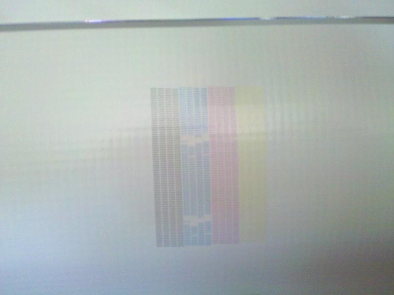

I am having problems with some cyan bars missing from my test prints on our sp540i. I've done multiple normal, med, and one powerful cleaning which didn't help. I was told that we should try replacing our cap tops. I just changed the cap tops and I still have the same problems.
Is there anything else that I can try to get the head printing correctly again?
I'm having problems with my greys being brownish like warm gray rather than bluer like a cool grey.

not familiar with the 540i test print. does it make two passes? because the missing nozzles on the top and bottom are identical patterns. one thing to note... when getting a concentrated "halo" of missing nozzles (and the missing area doesn't move around), that is sometimes a sign of a clogged up head manifold.
also, have you gotten a visual of the bottom of that head?
m_s_p
The machine does make 2 passes for the test print. How can I take a look at the head? Do I remove the maintenance cover and move the heads to the left side?

Any improvement after powerful cleaning? It's the same problem all the time? Did you had a head strike?
Take a cleaning stick with cleaning liquid on it and gently touch the print-head surface(not rub but easily press). Try also to take the cap-top out from the pump line(there is a joint there), grab a syringe and pull some ink through the cap-top (of course the print-heads must be in the capping position). You should have vacuum in the syringe and you should pull ink. Do that couple of times(2-3 times -depending on the syringe). If you don't have vacuum in the syringe, then maybe it's the damper or the manifold. Then, if everything is ok (have vacuum and pull ink in the syringe), do a normal cleaning from the menu. Do a test print and see if there are any improvements (new nozzles "returned").

m_s_p
No improvement after the powerful cleaning.
I believe it is the same problem all the time.
I had a few head strikes last month, but didn't notice anything wrong with the prints at that time.
Over the last few months a large corporate client has changed from Warm Gray 11 to a cooler Gray 425. I had no problems matching the WG 11, but I have a lot of problems matching the 425 which made me look at the test prints and Cyan head.
I'll try to get my hands on a syringe and see if that will help.

I was able to pull ink with a syringe. I pulled about 6mL. Is that enough or do I need to pull more?
Pulling the ink didn't help. I also tried cleaning the head which didn't help either? Anything else I should try before I get a tech out to change the head?

Just try to pull more ink..see if that helps. If not, then a technician is required to replace the print-head.

I've tried pulling more ink and no improvement. When I print a mix of 30C 0M 0Y 25k I still get M and Y in the print. Is that a result of the bad cyan head or could that be a different issue?
When I had the head strikes a month ago the head was moving right to left so it hit the MY head not the CK head. Do head strikes usually affect the head that hits first or can it affect either head?

if you had a head strike and the printer didn't get worse after the strike, you didn't get any damage from it. you are in the clear. if you are dead set on changing the head. take out the head. take off the manifold and see if it's locked up/clogged on that side. you've got nothing to lose.
