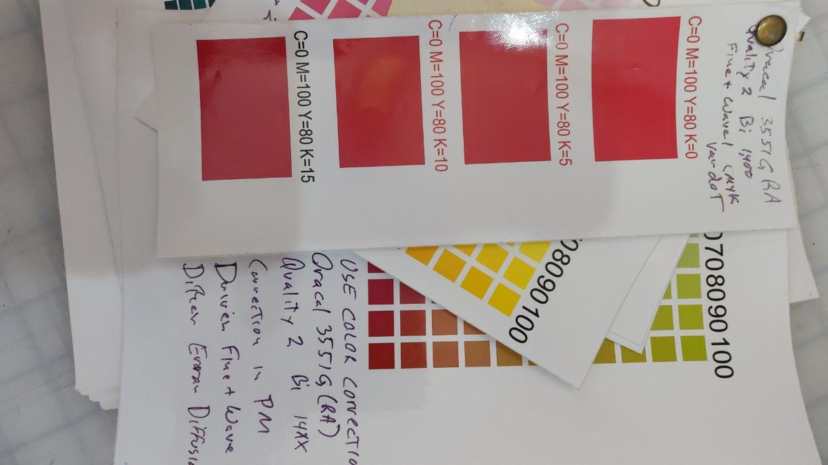

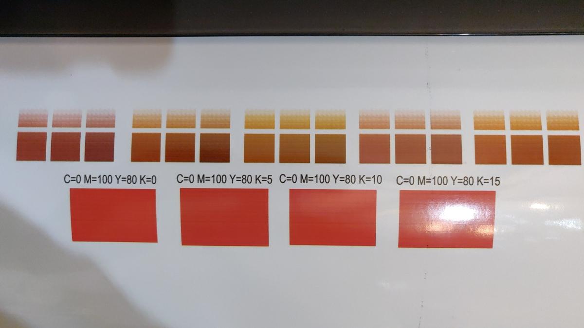

I use CMYK and my brightest red is using M=100 and Y=80, then I add K from 5 to 15 if I want darker reds, K=15 gives me a blood red. I attached pictures but I don't know if they show the difference very well. In person it's obvious. I'll follow up with screen shots of the settings first chance I get.
And Thanks very much for your interest in helping.
