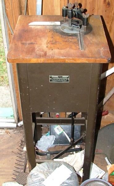

a77
I have one of the old lassco floor model rounder, and I have the die for 1-5/8".
You can pickup these things for nearly nothing, new dies are $80-$120 on ebay I think.
