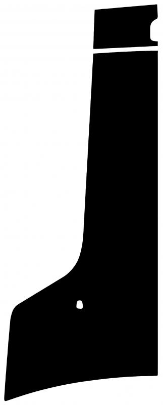

You can make you own
I see you are a Photoshop/Illy user, attached is a low res bitmap, you can scale it up in photoshop, tarce it in Illy and make your own cutting template, all you need to do is measure two points on the hood to scale up to. You should be able to do this fairly quickly as long as you have the exact dimensions off the hood.
Hope this helps!

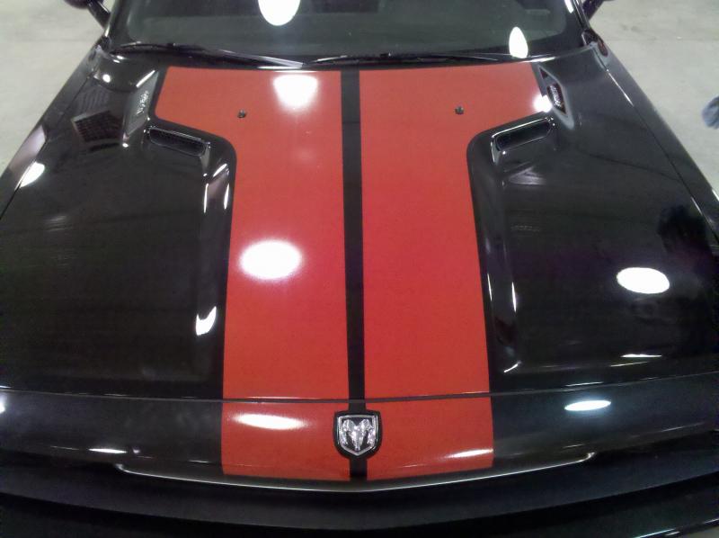

We ended up doing it by hand making a pattern, just got car done and to customer on time. am uploading pic now off phone will post in a few minutes. THANK YOU for the help, this is a great site and was the first place i turned once i realized vinyl graphics wasn't going to be able to help us. again TY very much this is a great site to be a part of.

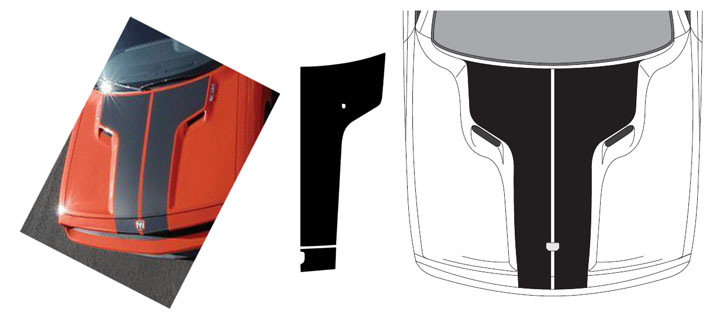

I checked out the pdf posted by the other poster, and as seen in the attached photo below, the location of the emblem cutout does not look right to me, it looks too high up, see the red car in photo.
Anyway, just wanted to point his out, if you use his or mine, I would recommend using a pen in your plotter to first the draw a paper template to place on the hood to verify which if either is correct.
