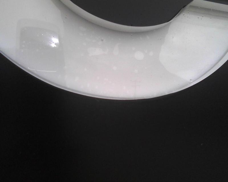

we just installed an internally illuminated sign and have a serious issue. the sign is aluminum with routed out & push thru letters. all the letters are filling with water (see photo). the sign has a customer supplied logo that has one part of the in white and the rest in a PMS green, all are push thru. we spec'd the sign so that the white and green would be painted on the front, not be opaque, but front lighted. the letters would be .5" thick clear so that there also is a side halo. the company that made this did just what they felt like doing and ignored all instructions, backed the clear with white so the push thru part is totally clear and used green vinyl on the fronts of the other letters...errrr.
my issue is the water that is seen in the letter. water trapped like will cause issues like green stuff growing and dirty blackening of the letter. we sent the photos to the manufacture who took three days to come with an answer that is is how these puch thru work and it is common for the letters to fill with water. I don't believe that. is it common? is it normal?

do you have any more pics of the sign itself, pics of top, zooming on water logged letter is not allowing to figure this out. Is it normal to be filed with water? no. its coming thru somewhere but without shots on the sign itself hard to see where

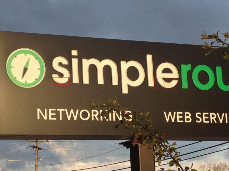

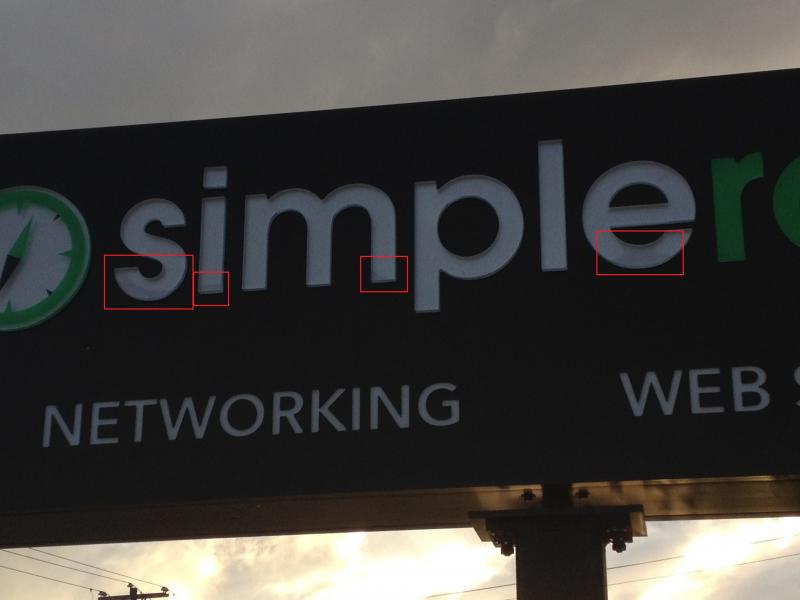

these are two pixs the customer sent us to show us what was going on. the sign was spec'd so that one side would have a face that can be removed to serivce the sign, sign is illuminated with white LED. the manufacture made it so both faces are hinged. the lettering on the bottom of the sign is routed and backed with white

I don't think the picture tells the whole story, but it looks like the manufacturer glued the clear acrylic to a white acrylic backer, and did a terrible job with the application, leaving air pockets between the two pieces.

the manufacture is saying this is "normal". I so don't believe that and appreciate the opinions from my peeps here. thanks for taking a look at it as nothing that was spec'd by us was done to make this sign.

now that is a little too much water! im wondering if its getting in thru the hinge at top? IF SO i would take some aluminum angle painted to macth the sign and screw it into top and let it 90 degree down the front of sign as a dripcap if you will that should alleviate this water issue not gonna be pretty but i dont think it will be that noticable

If that is water, this is not normal, if water is getting behind the letter in that amount, that is poor adhesion (or application) to the backer. When water can get in, other crap can. There might be some bubbles, or voids, but this seems a bit too much.
I usually prefer to rout the letter and leave a ledge that would hold the letter in place inside the cabinet instead of using a backer that can sometimes fail, or in this case, trap water.
totally agree!!! this was how it should have been made

Looks like they routed the letters with a ledge and then used a backer behind that without gluing the letters down which is not uncommon and allows the letters to float while being held in place. There should not be that much water in the sign though, it must be running down the inside face and sticking around where the backer and letters touch more. Needs to be fixed for sure.

thanks for all the replies. this sign was not made correctly and needs to be replaced as it will only get worse as time goes by and things start to grow in the standing water behind the letters. it is normal for a sign to leak and that's why there are weep holes. I'll let you all know how this turns out.

Its actually not normal for a sign to leak - the weep holes are there mostly for condensation and unexpected leaks. A leak like yours will make a lot of condensation inside the cab and the wiring will be trash in no time.

The rout-out push-through (ROPT) portion including the flange should have been CAD-cut as one piece from acrylic. There's no reason to mechanically fasten the flange portion to the push-through portion. Any desired colors (background, etc.) could have been achieved with vinyl.
In my opinion they need to redo it or not get paid. It's simply not built properly.

we seal our push-thru letters with clear silicone AND, in most cases, back the clear letter with white trans. (or other color) vinyl.
if not, water spots will be the least of your worries... bugs are attracted by the light and will fill your letters with hundreds of corpses in no time.
