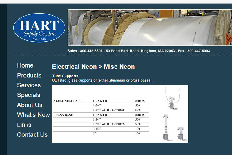

look like these?
petrosgraphics
the tube supports from hart supply are alum. base with a glass support. they sell them as short or long. if you are not sure what length you need, buy the long ones and you can easily cut them down to the size you need using a pair of wire strippers. that is why they are grooved, so they can be cut
