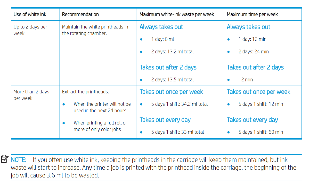

If white ink is being run on a daily basis there is no benefit from offline storage in the wheel.
HEAVY WHITE INK USAGE>2 days per week. Maintain the white PHs in the carriage, extract if:
•On weekends or when then printer will not be used in the next 24hrs
•When there is a long color job or two or multiple short jobs
Keeping the printhead in the carriage will keep them maintained but ink waste will start to increase.

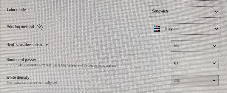

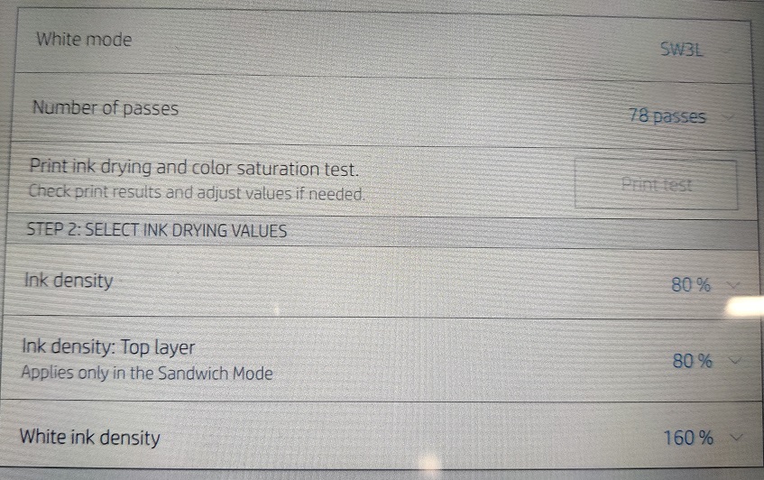

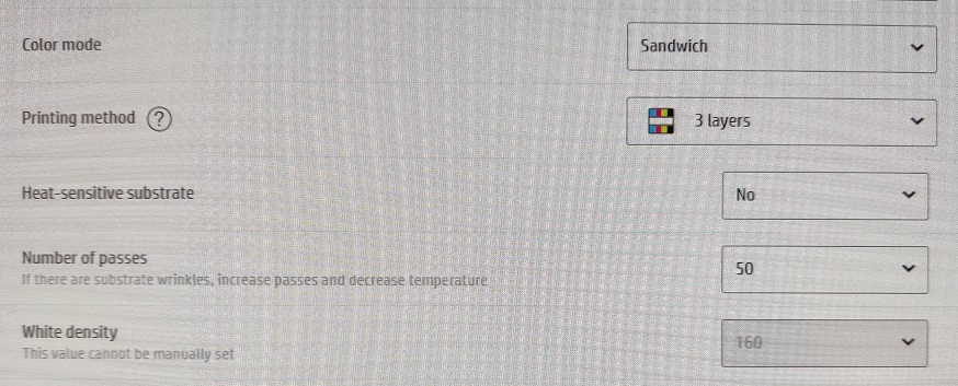

So it's not the same white as if the R series on 32 pass? The sample I was shown was near Identical on the 800W and the R Series
I don't know why they told you it was 32 pass because it's not. 32 pass could be under/overflood. White ink is the same on both printers.
The same printmode 3-layers 160% white is 50-pass on R-series and 78-pass on L700/800W. This will result in pretty identical output.
On R you also have the 5-layer 290% white blockout 61-pass. That's pretty good for opacity.
(There is some small differences between materials on printmodes)

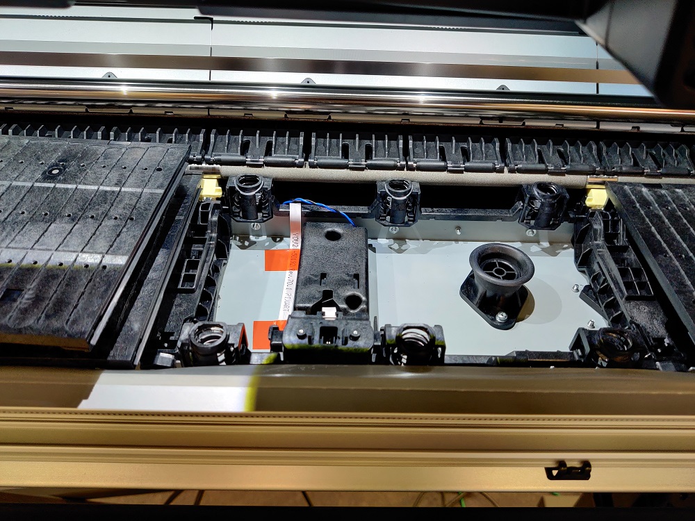

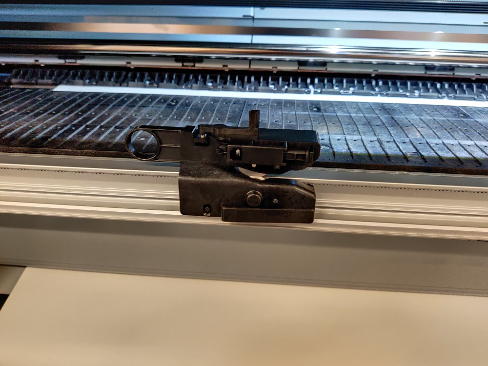

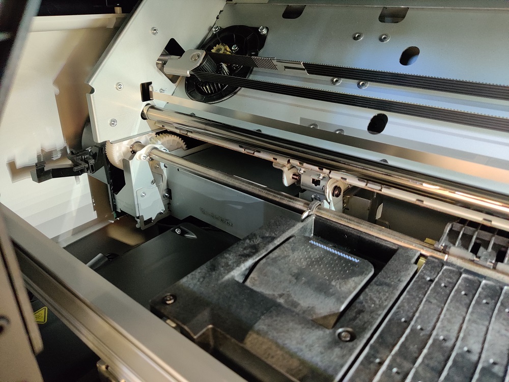

For people who might be interested in the mechanics side, here's few interesting things.
New drive roller that is like 1/2" inch diameter. Old one was closer to 2" diameter, a lot more precise movement than before. New OMAS and platen design, they lift out in pieces like this. And the new cutter.

I was watching a video on the new printers, did I see see this correctly - if you aren't using white you need to remove the heads, put them in some plastic box, and back into a special section of the printer that spins them? And when you want to use white, remove, readd, print, rinse and repeat?
What is the recommendation on this? If I am not printing white for 1 day, 2 days, a week, etc, I should go through this process?
Finally found this official graph.
