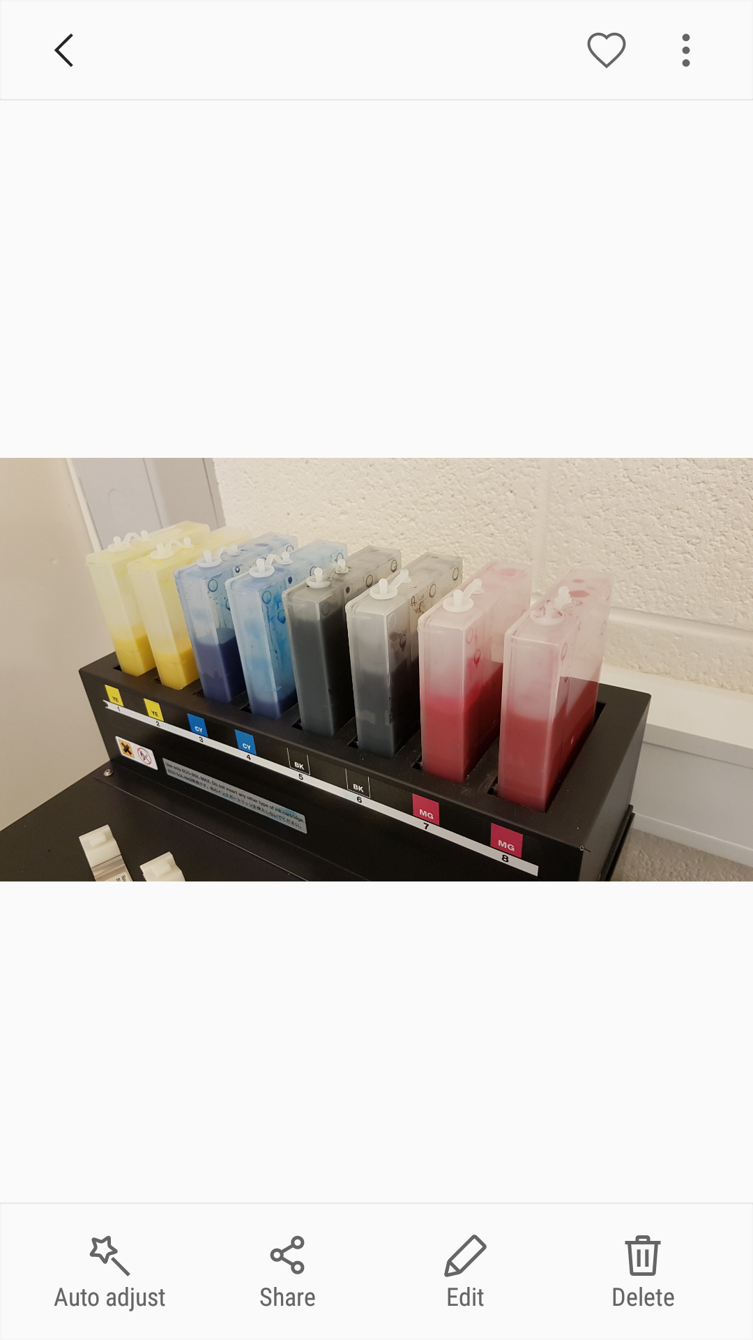

hi I've just switched to new refillable ink cartridges. However obviously as the ink is used the space needs to be replaced with air? how does the air enter to stop a vacuum being created? each day I'm currently taking out the stopper and 're fitting it.... Surely there should be a little hole in the top?

We had a similar system previously and were told not to tighten the plugs just to let them sit loose in the holes.

You just leave the small holes open. That is a breather. When you need to remove the cartridge, then both holes should be closed.
bilge
you're welcome. In addition, the cartridge has two sections, small and big. Small part is a indicator. You don't need to top up everyday. Ink in the small section stands still, while ink in the big section drops according to usage. When ink in the big section is not visible, then fill it up. If ink is not visible on both section means it is near end i.e reached down to 2cm. You should keep 2-3 spare cartridges or even set of 8 handy. I think it should be 10 bucks per cartridge. Also change it every year. Sometimes it leaks through the rubber plug. One plus of these cartridges you'd be able to see how ink system acts. After a cleaning cycle, all channels' ink level should be down at same rate. If not og-oh.

You can also buy these little "air filters" instead of leaving the plugs loose or off to prevent dirt from landing in your ink.
Amazon.com: 6 PCS Air Filter for Continuous Ink Supply System CISS CIS: Office Products
