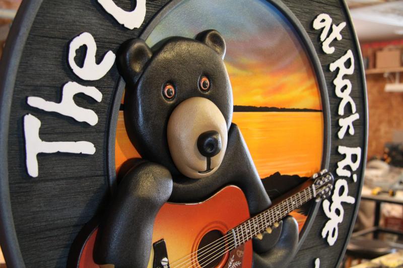

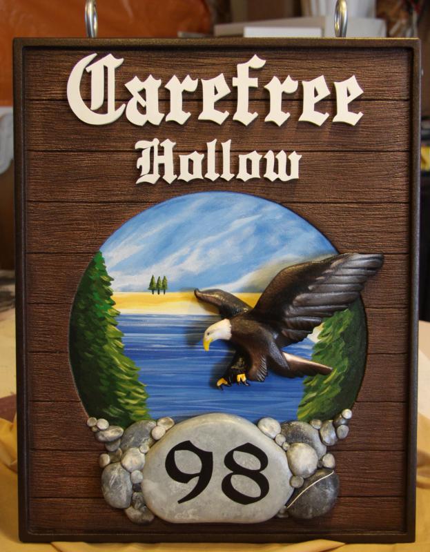

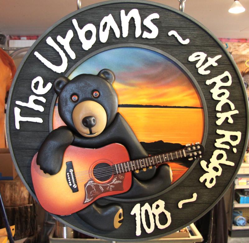

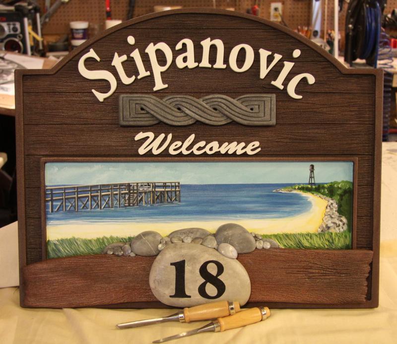

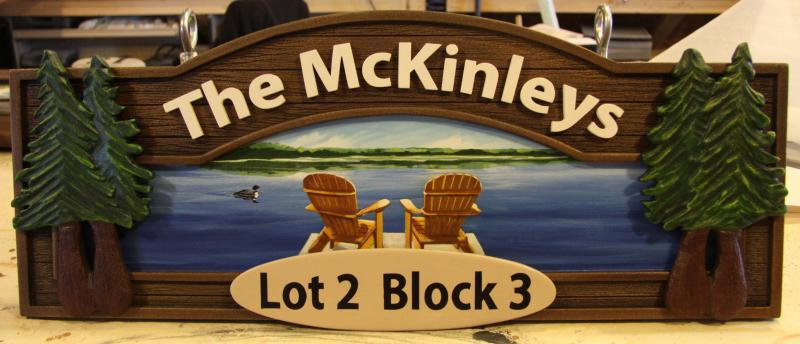

couple questions for ya, if you dont mind?
you said you use HDU 18#.
I'm assuming you used layers to make each object?
What did you use to adhere the objects to the main board?
Thanks

Hi Testtube,
Yes I start with 1" 18# HDU, will be moving to using 20# very soon. I try and carve as much out of the base substrate as i can and then layer on top of that, i have tested a lot of different glues over time and i always have used a 100% Polyurethane, I use LePage Premium Construction adhesive, I have used a sledge hammer to test this glue and the substrate failed before the glue did.
One other glue i have been also trying is Coastal Enterprises PB Bond, This works great on Larger surface bonding and is made for the HDU. I don't use this for smaller pieces because it expands.
I hope this helps!
piccadillysigns
Yes I use all kinds of chisels and Rasps, along with lots of other woodworking tools,
I also use all the same PPE that you would use in wood working, just to let know!
