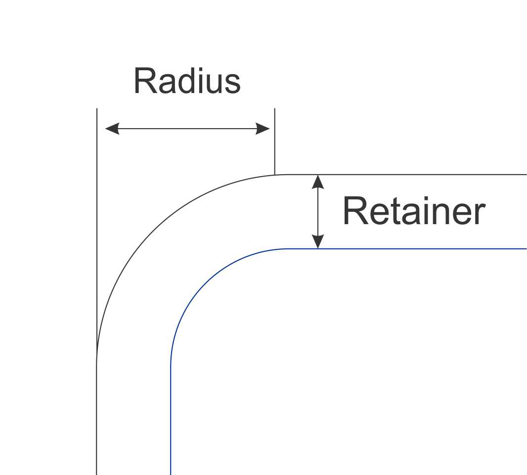

I believe he needs to reface a sign with radius corner, we usually get the size of the cabinet you do not need to rub the entire face. You need the retainer size for your face to fit and if you do not know how to measure a radius the rub the retainer corner and have your designer lay it out for you.
