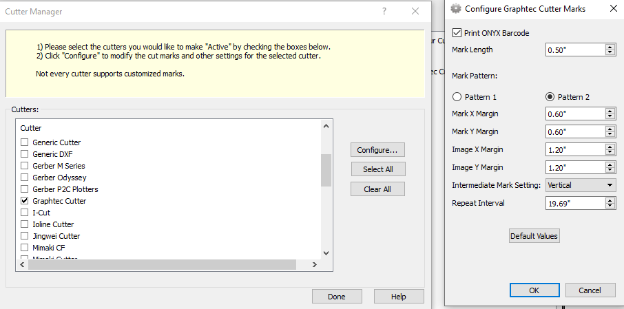

Only place where the setting to change it could be is in the main window, top left File - > Cutter - > Your cutter - > Configure
These are my onyx settings for an FC8600. Not sure how different yours need to be for your cutter but might be a good place to start.
