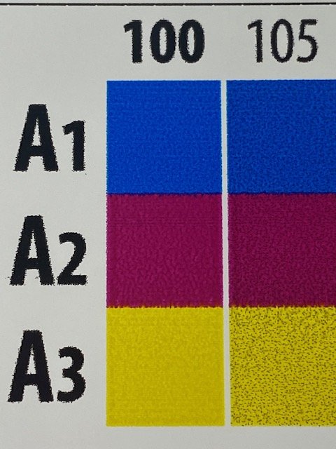

We have trial of Onyx Thrive and so far so good. As of right know we are getting good color with generic profiles. However, we are trying to write some profiles and are having a problem with our ink limit. We print and read our ink restriction and calibration and everything seems fine, but as soon as we print an ink limit it seems over saturated and bleeding even on the first swatch and you can 't go any lower than 100. I attached a pic of what is happening. What are we doing wrong? We have written many profiles with Flexi but we keep having issues with Flexi software and there color matching is awful.

bad stock, or bad comms, or bad heads. ink limits are more of a quantity rather than a quality-thing.

the issue seems to be with the stock (not coated) or the printer sucks.

I see nothing wrong with the image of the Onyx ink limit swatch the OP posted. I suspect the OP could use some training in both Onyx and Flexi as well as printing in general.
