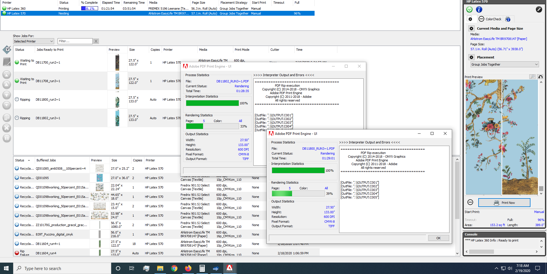

Having issues with our rip system. We had an issues with our system and had to re-install windows 10 on our system. So we have a fresh install of windows, and a fresh install of onyx Thrive19 that we downloaded direct from their website just like we did for the original install. now we are having issues with it Rendering PDF files. Tiff Files, and every other format Rip instantly. When attempting to Rip a PDF, even just a one page PDF it takes over an hour to Rip. It never took this long previously. Has anyone else had this issue and resolved it?
I've been on the phone with Onyx support twice, they remoted in and went through everything and they cant figure out the issue. Ive transferred the same files I'm trying to Rip here and they can rip them instantly. When they try to do it from my machine it takes over an hour. this is killing me production wise. Any help would be greatly appreciated.
* Yes we do have an anti-virus program, an exception has been made for the thrive folder, didn't solve the issue.
we have even disabled the anti-virus, still nothing, so we removed it just to see.. nothing is fixing it.
** we have also removed and re-installed Thrive19 as well.
