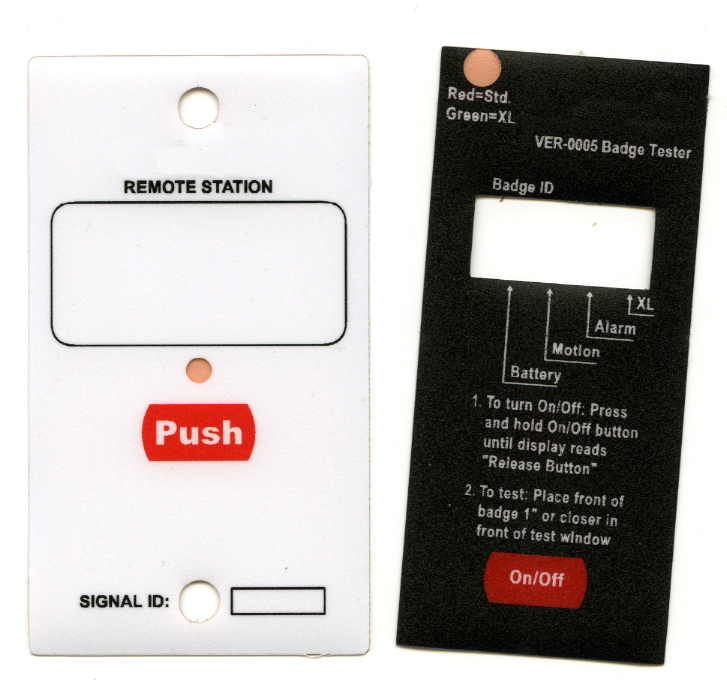

Bill Modzel
I'm missing something here.
The labels that I'm doing have either two holes or a small "viewing window" for
an LCD screen in them.
Once printed, I laminate an adhesive with a clear poly liner on it. The registration mark is easily visable and I cut them from the "back" side or
print side of the .005" poly.
If your are printing the face side of the normal polyester decal stock and than laminating the .005" poly over the face of that, how do you cut it? You might be able to score cut the top lexedge, but than you have to cut through the polyested decal stock and the liner also.
How are you guys accomplishing that?

Bill Modzel
rudeez. Wow, you have enough cutting control to cut through the lex AND the poly and still leave the liner intact? I don't know if I could pull that off with my GsxPlus. As it is, I'm cutting 4 passes at about 4-5 in pressure and still have to bend and crack them out.
The adhesive I use is special ordered and has a carrier that is about 3 mils all by itself.
Here are a couple of the labels. The pink areas are not printed and show the adhesive carrier which is pink. The white decal has two holes cut out and the black one has the rectangle cut out.
I guess your technique might work if I can get enough pressure on it. How much are you using? My customer is used to receiving these as shown so I'd have to change things a bit.
