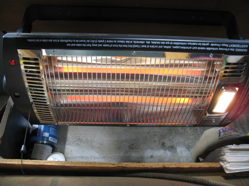

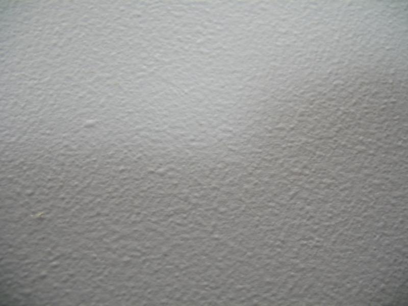

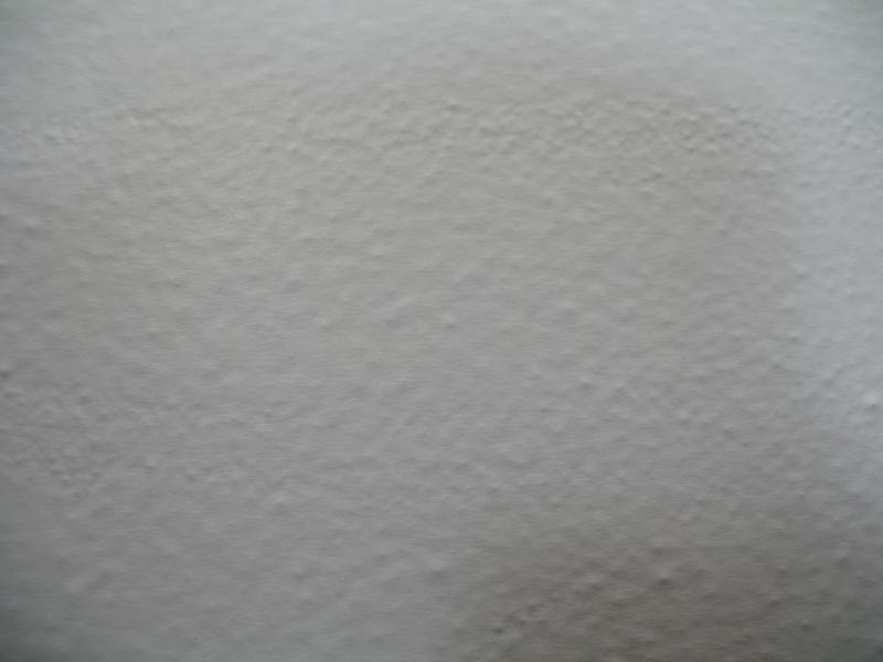

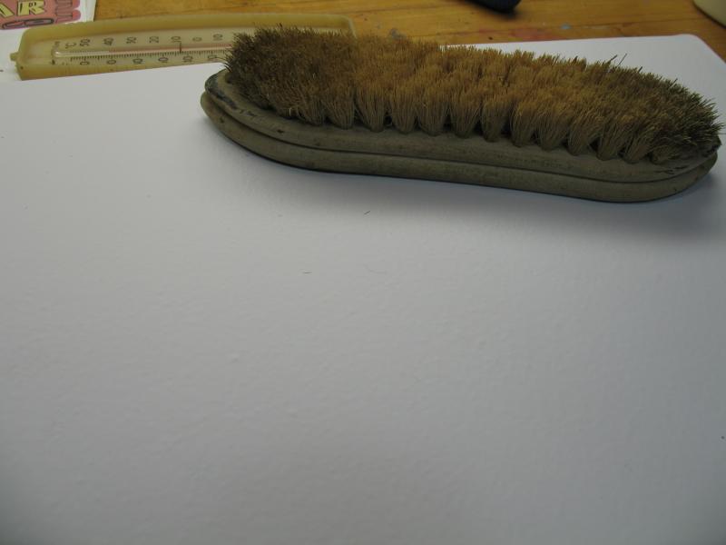

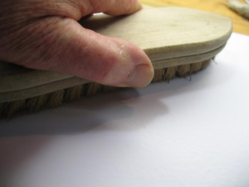

If the orange peal isn't the problem but the vinyl sticking to the textured surface is, then this might help.
I WANT a textured surface. To get the vinyl to conform, I heat the surface of the sign with an overhead quartz heater to about 110 degrees. Lay the vinyl on it and scrub it hard wih a natural hair floor brush.
1st pic....textured surface
2nd pic...quartz heater
3rd pic...vinyl before "scrubbing"
4th pic...scrubbing
5th...vinyl conforming nicely.
I would "scrub" it with the transfer tape still on.
I got the idea from the rivit brush.
Maybe this will help.
