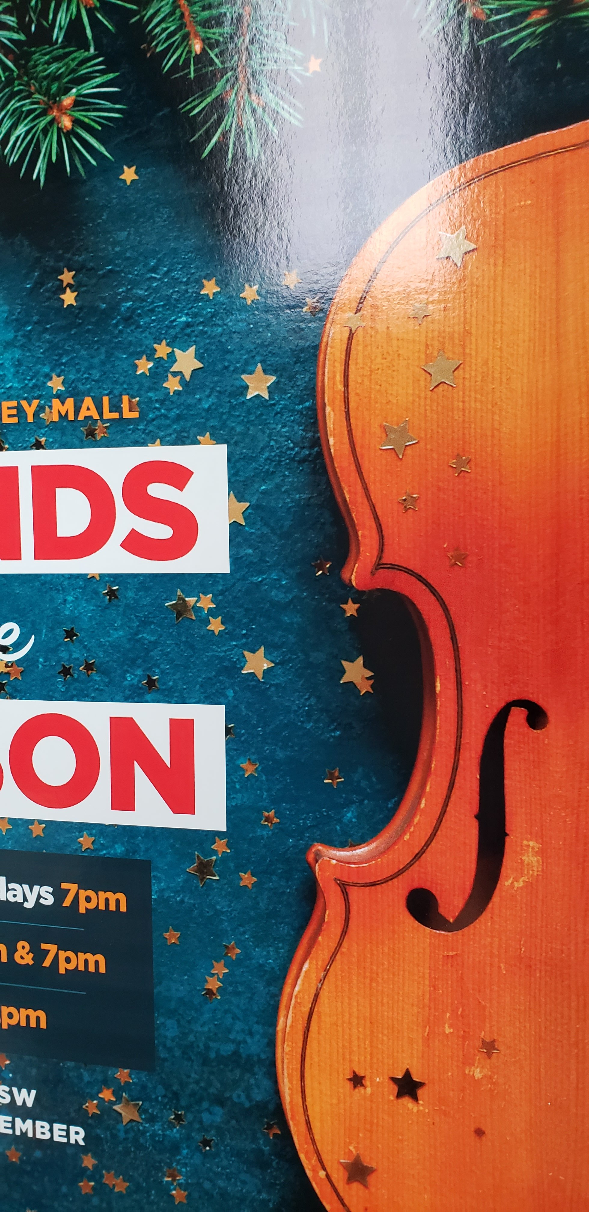

Just curious for opinions. Long story short, I've gone to Color Management classes and I understand most, if not all the principles and setup to create profiles regarding ink limits and linearization etc. However, since we got this new Epson, and Flexi doesn't seem to care about this printer too much by providing NO profiles whatsoever.
I've created two different profiles for this printer and they both seem to over saturate red or magenta in anything that is actually a photo. Vector graphics seemingly have a terrific vibrancy and the colors are fantastic, but if I send anything with a photo in it, it is way warmer or redder than it should be. My ink limits are pretty good, but this is the first printer we've ran that has Red and Orange ink. My rendering intents for photos are set for 'perceptual' in the RIP and according to my gamut reports, there is virtually no arc in the tails in 'spider view' so I don't think it's too much ink in those channels.
Any ideas on how I can manipulate my profile to still get nice rich colors, but not go overboard on photos with people or objects?

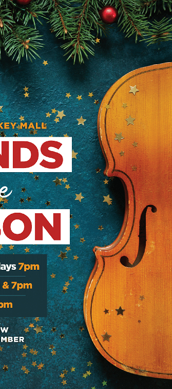

Example below, one is the actual print and the other is a screenshot of the file.
Any help is appreciated, Thx guys
-N8

Because you're not using the recommended Epson workflow, you've chosen to walk the bleeding edge. From your color management classes you should remember that troubleshooting requires removing all the variables you can afford and not be shy about it.
That first step is printing the Flexi printer control image while choosing the options to print with all profiles off. This removes the variables of your workflow settings coming into the process and any suspect settings from any ICC output profile creation process by any third party, including Flexi themselves.
Make a print of the control image with, and without, the printing using ICC color management and post of photo of the two prints side by side.

What is the 'recommended Epson workflow'?
Game Print for starters and especially for those inexperienced with color management.
From your previous CM courses you should have been exposed to the notion that one can test ICC output profiles by using Photoshop with its soft proofing and "Convert to Profile" features without expending costs of consumables if the profile exhibits flaws in preview. Because you've created a multichannel output profile, you might see the same reddish bias by invoking the advanced option of Convert to Profile. In your case, I recommend creating a simple CMYK profile as starters. Also know you can have any of your RIPS share any ICC output profiles on the machine, at least for troubleshooting.
Since you seem to have the tools to generate profiles and you say you understand ink and linearization setup, I'm not understanding why you're looking for 3rd party ICC output profiles which would likely not share the calibration of your particular machine.
