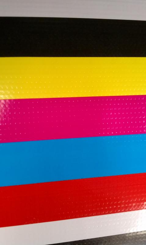

Hello All,
Please take a look at the attached picture and you'll know what I'm trying to ask. I didn't know how to describe the problem. Sometimes a picture worth thousand words.
Could anyone suggest what causes two tone effect and how to remedy the problem. One band is slightly lighter than the other.
I can tell you this, it is caused by the magenta and it prints a beautiful test draw on all channels as well.
Thanks very much for your input!

artbot
recently there was a discussion about a banding issue with the dx4 head that was unavoidable even with perfect calibration. ...think it had to do with some particular pass configuration.

artbot
i've recycled dampers, if they look clean, they shouldn't be a problem. i've stuck dampers in ultrasonic before. that gets them back to brand new. you'll first have to prove which color is starving/banding. put together a file of c m y and k blocks and print them. see if one color looks bad during printing. after that, it's a matter of doing a damper swap with a working line to see if the issue migrates.

mustafade
Does it do the same thing in uni-direction mode? If not, it looks like a case of "lawn-mower" effect.
I did not try it with Uni-directional mode yet. But i know one thing it was not doing it before on 4pass 540x720 bi-directional mode.
What is a lawn-mower effect?

SightLine
Have you run a dot position adjust lately? Might help some - not really sure though. Thats a pattern I've not yet run into on our JV33.

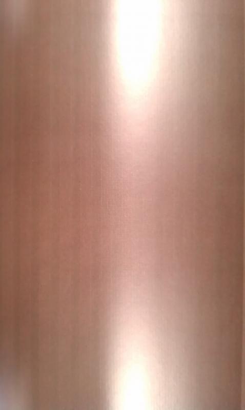

mustafade
Attached picture is the CMYK test 1" blocks I even did a 100%Y & M=RED.
It looked good to me.
I don't get it ya'll!
I did not get this much challenge from my good old Epson9600, I still don't.
JV33 a solvent beast thou that's why.

SightLine
Actually I was callign it the worng thing.... its Drop Position Correction under Funtion>Maintenance>DropPos.Correct. It is a user function that you should do about once a month. Pretty easy - uses about a 2 feet of material.
Run it and you will get 12 (pretty sure) sets of lines. Once they print you just enter the best aligned one for each of the sets on the control panel.
May or may not help your problem though.

HulkSmash
It could be a feed adjustment. Usually when you get light banding your % is too high and if its dark it's too low

Sticky Signs
lawnmore effect is a bit tricky to explain but I'll try. When the head travels from left to right, it fires the inks and the ink droplets land on the media. The ink does not land perfectly straight with the media though because of the momentum from the head traveling. Now, the same thing happens when the head travels from right to left only this time the momentum is in the opposite direction which means the droplets from the second pass are slightly different from the ones in the first pass. So the two pass are in essence opposite of each other. Kinda like the lines one get in your lawn after mowing it.
I hope that's a good enough description... I'm still on my first coffee.
I find that certain colours are always problematic no matter how well tuned my machine is. When faced with the issue, I just run the job in uni-mode and that usually takes care of the problem.
