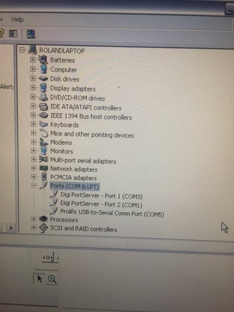

go tomdevice manager>expand ports>
highest number will probably be the one for the usb converter>right click>properties>advanced

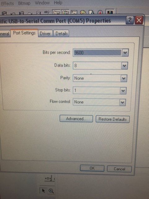

i think it is just flow control mismatch, that's why it starts cutting, empties the buffer and doesn't have a chance to request more data

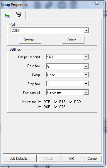

If all the jumpers are off position on your cutter, this is how your settings should be.. You told us earlier the only change is the USB adapter. They not all can be trusted. Sometimes the cheap ones are better.

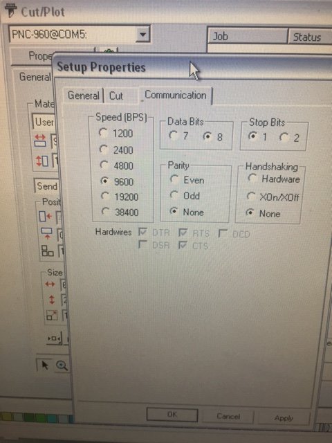

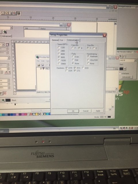

please see my port settings in the attached images

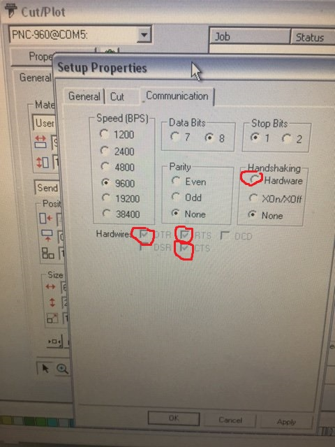

Can you see !, You have no flow control enabled. It tells the computer if the cutter is busy or ready to receive more data. without that the computer keep sends data, but the cutter cannot store it and it overflows.

Your cutter is Fine. just marked the buttons you need to enable and make sure all dip switches are off position on your cutter.

I tried that and it didn't do very much. i tried to send a 6 seconds video to show you what happens but I can't.
When it was 'None', it did attempt to cut the vinyl
