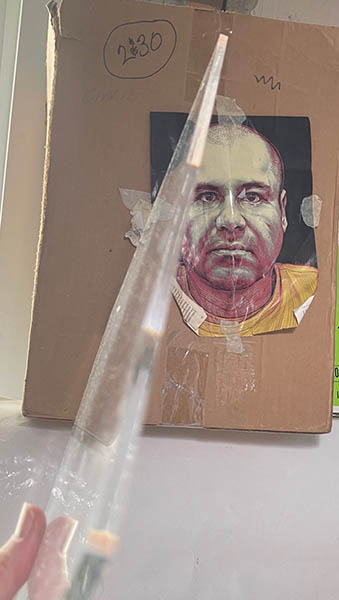

Buffing wheel on an electric motor with compound brick.
Just polished some edges today. Hard to take a good pick with IPhone.
