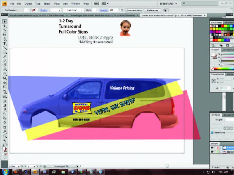

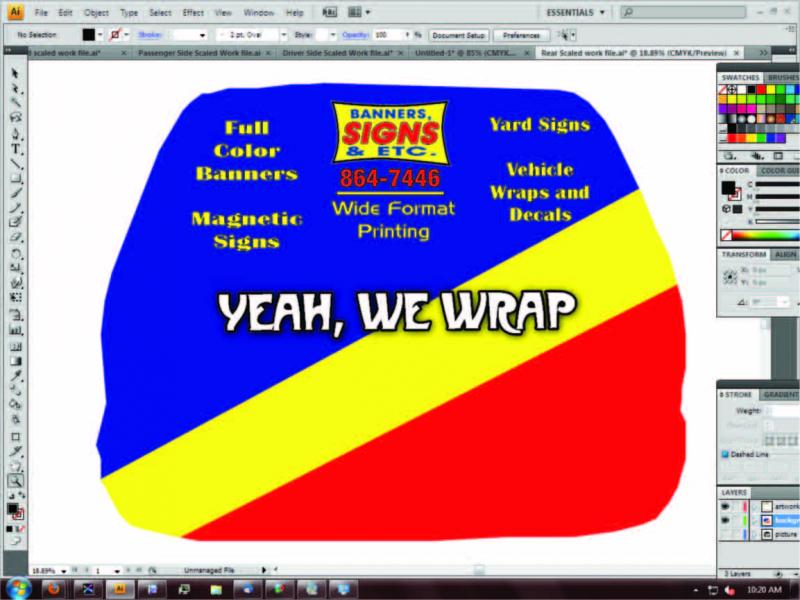

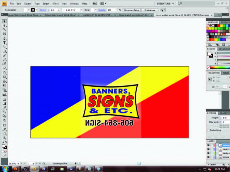

Here's my design for you to tear apart...(keep in mind Ima Design NOOOB)
The tentative side, rear, and hood...still working on it. But what do you think of the simple color scheme/design?
Sadly all I have are screen shots...because like I said I'm learning design still.
I played with some tileable stuff but the message kind of got lost to the clutter
I was thinking of using black on the corners and where hood connects to fender to break it up
Our lead designer is very talented, but working on paying jobs while the production side is a bit slow...so this is my attempt...I'm sure she will tweak it but any input would be greatly appreciated.
:thankyou:

ummmmmmm,... those angles are going to prove tricky around the corners,....jus' sayin'......keep tweeking,.......

1. You can't use a BS to laminate a wrap. You really want heat assist so there's no silvering in the lam.
2. Don't use cheap vinyl, or you'll have a bad first experience at your new shop. And it wont last as long, and it'll look awful. Show your customers you do quality work.. not half a$$ stuff.
3. That design is awful, let your talented designer design it when he has more time.. it's worth the wait. And if your talented designer designed that logo in your avatar..... then find another designer.
4. This will represent your company.. don't do something half way. Make it right the first time, and you will bring in more business.

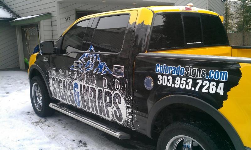

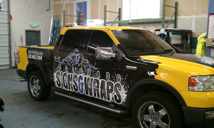

Attached is our latest wrap on one of our shop trucks. We tried to be unique and do a partial wrap like i've never seen before. Really wanted the paint color to come through, and keep it simple, and big.. showing what we do.
good luck.

K....I will also be nice...But i will be honest.
1. That design made me throw up in my mouth. (Trust me - I'm being nice. Ask around)
2. If you try to wrap without laminated materials, can i please come and watch?
3. You must use cast air release materials. The cheapest material on the market worth using is the Arlon stuff. Although i don't like it. I'm a fan of the Avery MPI stuff. Either way, a roll of material and matching lam is going to cost you around $1000-1100. And believe you me - if this is your first major wrap, you'll be using most of the roll.
4. The Big Squeegee is not a wrap tool. It is not a large format lamination tool either. Buy a laminator. There's no point in even owning a digital printer if you don't also own a laminator.
5. I just looked at the design again. Breakfast REALLy doesn't taste the same the 2nd time around....

Looks as though you might be biting off more than you can chew. There are places you can cut corners, but none of the areas you mentioned.
If you put a wrap out there representing your company trying to attract new business and show off your quality/ability..... design, cheap materials and poor quality will work completely against you with your formula.... so far.
Wait for your lead designer to give you some tips and how-to's before you present this to the boss.... or you just might be looking for a new job tomorrow.
good luck.
Adam ... WOWSA!! That wrap kicks MAJOR a$$!!:loveya:

Great advice and great looking wrap! Very well executed partial wrap...
But it would surely look better on a Chevy :wink:
Just messin' with ya, great job!

As has been said, the design is terrible. Like it would take away from business rather than help. Not everyone is a designer, but if you're not a designer, don't try to be. If you want to be a designer, learn on your own time, not on your first vehicle wrap. Just saying.
Also, sorry, unless you're just printing banners, owning a printer without a laminator would be like having an autobody shop that specializes in water based paint, but doesn't know how to clear coat. Aka it's absolute freaking insanity. I don't even want to hear the "no funds for the laminator thing" as I was 18 years old and got a loan for my first printer than dropped the cash to pick up a 52" laminator. If I could do it as a punk kid right out of high school, a business with some form of capital (I hope), and employees should be able to afford to get the right equipment to run a business.
So, my suggestion for you would be to leave the design to a designer, OR outsource the design. I would honestly ditch that hideous logo too but if you're stuck with it...meh, you're stuck with it. Just make the rest of the wrap look good. Then buy a good roll of media and lam as has been suggested, and then, get to wrapping. If you have free time you can teach yourself a lot just by laying the vinyl. Sounds like you have a decent idea on how to apply already so just teach yourself how you go. You'll quickly learn how the vinyl works and figure out some tricks. You'll probably lose a few panels in the process, but hey, all part of learning. Just keep at it until everything looks good and is lined up well and you can finally say you did your first wrap!
So, I wish you luck sir.
