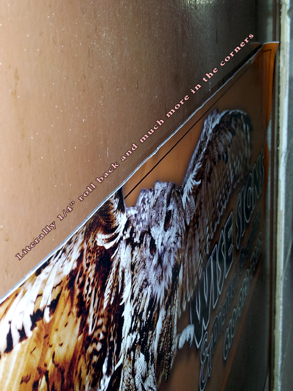

Most of the time, our flatbed is tied up and we find it cumbersome to stop everything just to run a set of magnetics through, so we print to the cast vinyl on our inkjet and we're done. Move forward to the last 6 or 8, 10 months. Many of the sets we laminated to the magnetic are curling up and going bad within weeks to months of selling them, forcing us to re-do what we thought was customer negligence. It happened to our own magnetics and WE KNOW what we do is right. Call Magnum and they tell us now that you cannot laminate cast or calendared to their product. My suppliers say they never heard of this, friends say they never heard of this and many people here on s101 never heard of this. Years ago, the distributors would tell us, rather than paint your materials a different color, just flood a vinyl background on and then continue with die-cuts. Now, all of a sudden that's a forbidden taboo.
Anyway, other than our lamps, heat doesn't touch our magnetics when using the inkjet method. Not even in the laminating stage. We do it by hand. No amount of edge pen will stop what's happening to our magnetics, either.
We don't run the magnetic material through our inkjet printer. Never have, never will. Magnum tells us it's the extra vinyl laminate of the print causing this. Nothing to do with heat. Just an incapable combination and they say they didn't change a thing. So, in essence, something which worked 100% of the time across the board, suddenly no longer works on a uniform basis...... and it's our fault. :rolleyes:
