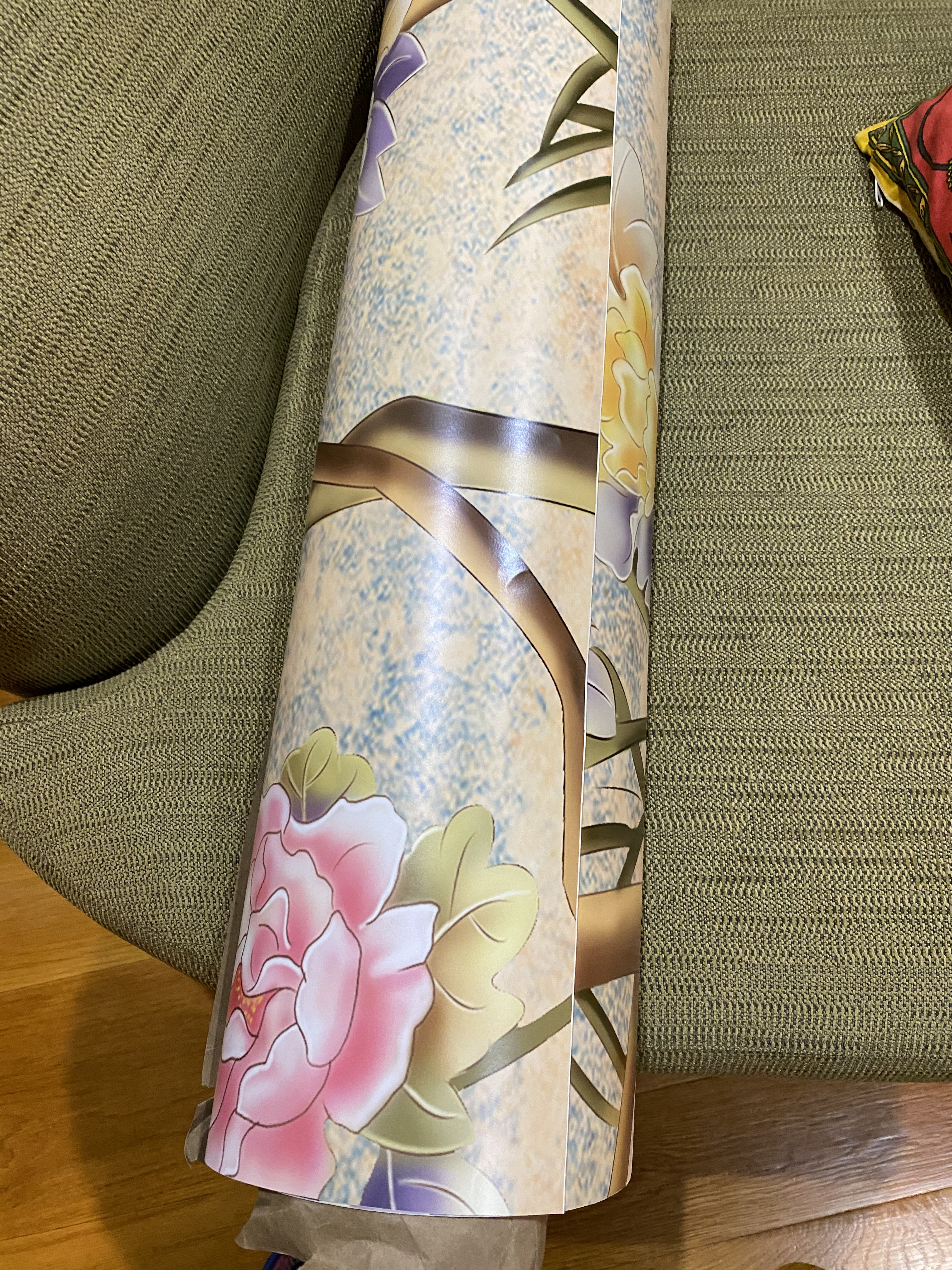

We have an S80600 so the same ink as you, when we print on matte material the end result is matte, however there can be a slight sheen difference between light and heavy coverage areas, perhaps this is what the client is seeing? the only solution for this is to apply a laminate over the print.
I attached the picture from customer.
Bly
Even matte lams will have a bit of a sheen.
