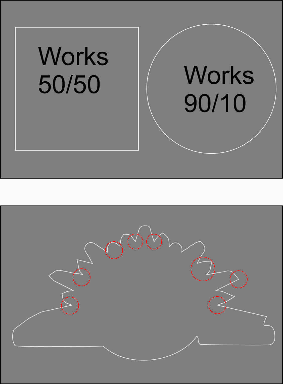

Been working on this issues for a while now, and I am getting nowhere.
When I print/laminate/cut stickers certain cut points do not cut, causing the excess vinyl to be extremely difficult to remove and there are little dags holding waste to product.
I have tried changing blades, blade offset, cutting strip, and have tried a few different things inside Corel.
Attached is a sketch of where the issues are happening.
Any help would be fantastic thanks!

Any photos of the result as it comes out of the cutter rather than a diagram?
Have you correctly set the blade depth and force?
Buy original blades, if they are Roland branded make sure they're new. Change cutting strip. Use higher pressure.
