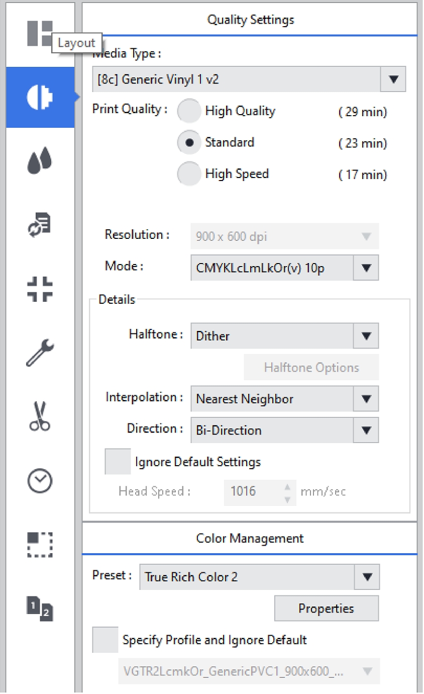

90% of all my prints are printed with this formula. Large part of all my prints are on Oracal 3751GPS / 3M IJ180SLE / Avery 2903EZ with the same amazing results. Bright colors (that match and, great ink coverage (solid color, like a real piece of color vinyl)

*After testing the same file with 5 different profiles, I came back to the 1st one mentioned above. I'm picky for colors...
