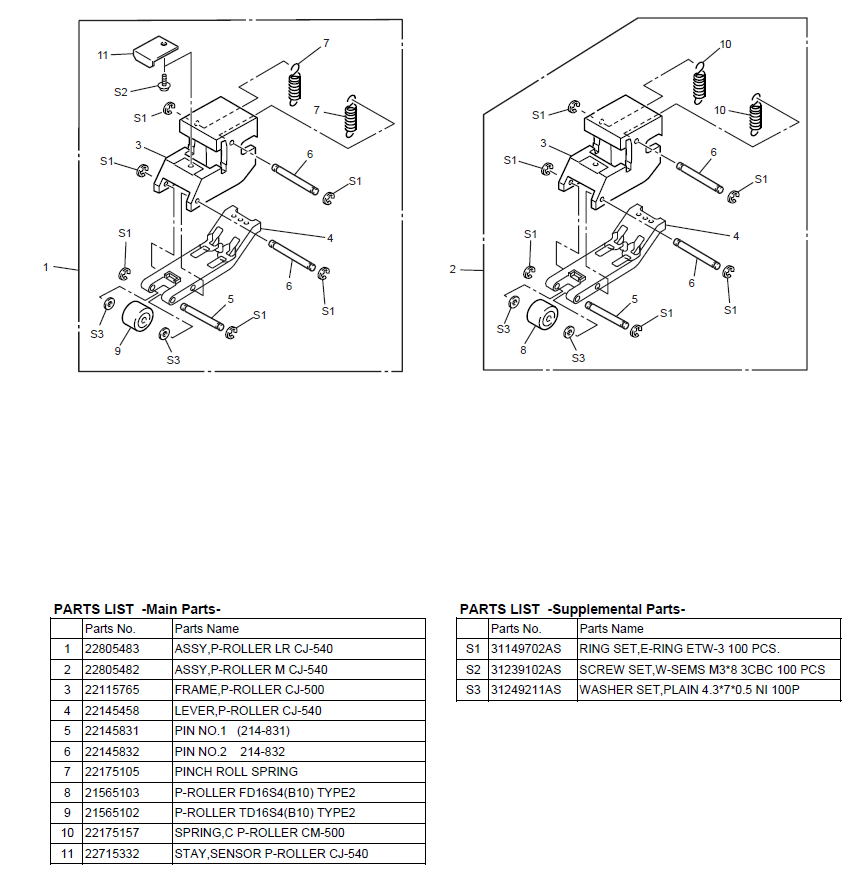

our SC545-ex was tracking poorly a couple weeks ago, and i broke the cardinal rule, i changed one of the end pinch rollers. (ALSO, I USED A CHEAP CHINESE ROLLER
FROM EBAY)
everything seemed fine until i loaded a roll of 38" 13 oz banner on sunday. it mis-tracks by several inches.
if someone can give me the part number for the outside pinch rollers, i will call in an order and drive to Tyreltek and pick some up, ending my problem (and my embarrassment,
since i would lecture anyone else about the 2 rules i broke

I was being lazy. There have been a few updates to that part. Any of these will work if you can find them:
For the L/R wheels:
6000003824, 21565102 or the current part number is 1000022932
For the Center wheels:
6000003823, 21565103 or the current part number is 1000023140
