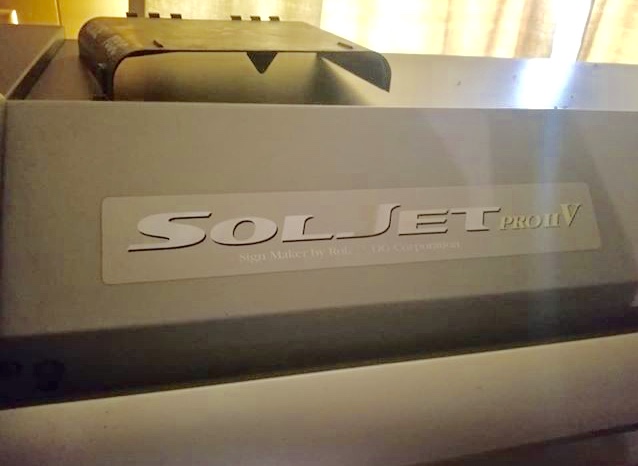

Roland Soljet Pro II SC-540 for sale $200?
Rebel Graphics
Guy wants to meet this weekend, says it only needs cleaning, inks and rip.
What should I look for when inspecting this printer?

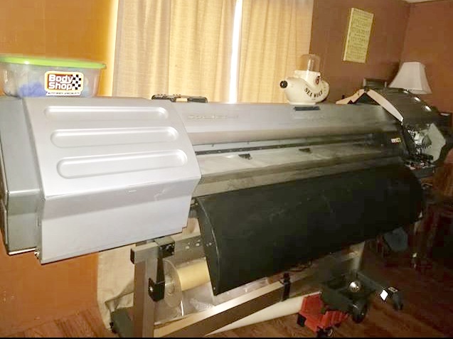

After a 6hrs round trip, here it is..
Anyone willing to help me restore this baby, it’s my first printer.

Printer was sitting idle for about a year and a half. I just finished putting it together and it turns on fine with no errors. Ink lines are empty as well as all cartridges. Got a hold of the service manual and this will turn into my special project.
Any checklist of all parts that need replacement based on routine maintenance?
Thanks
NazGraphics
oh yes that would be a good project good luck
open every single compartment and see if there is any bird nest lol
soak the head in mild solvent
dust of the motherboards

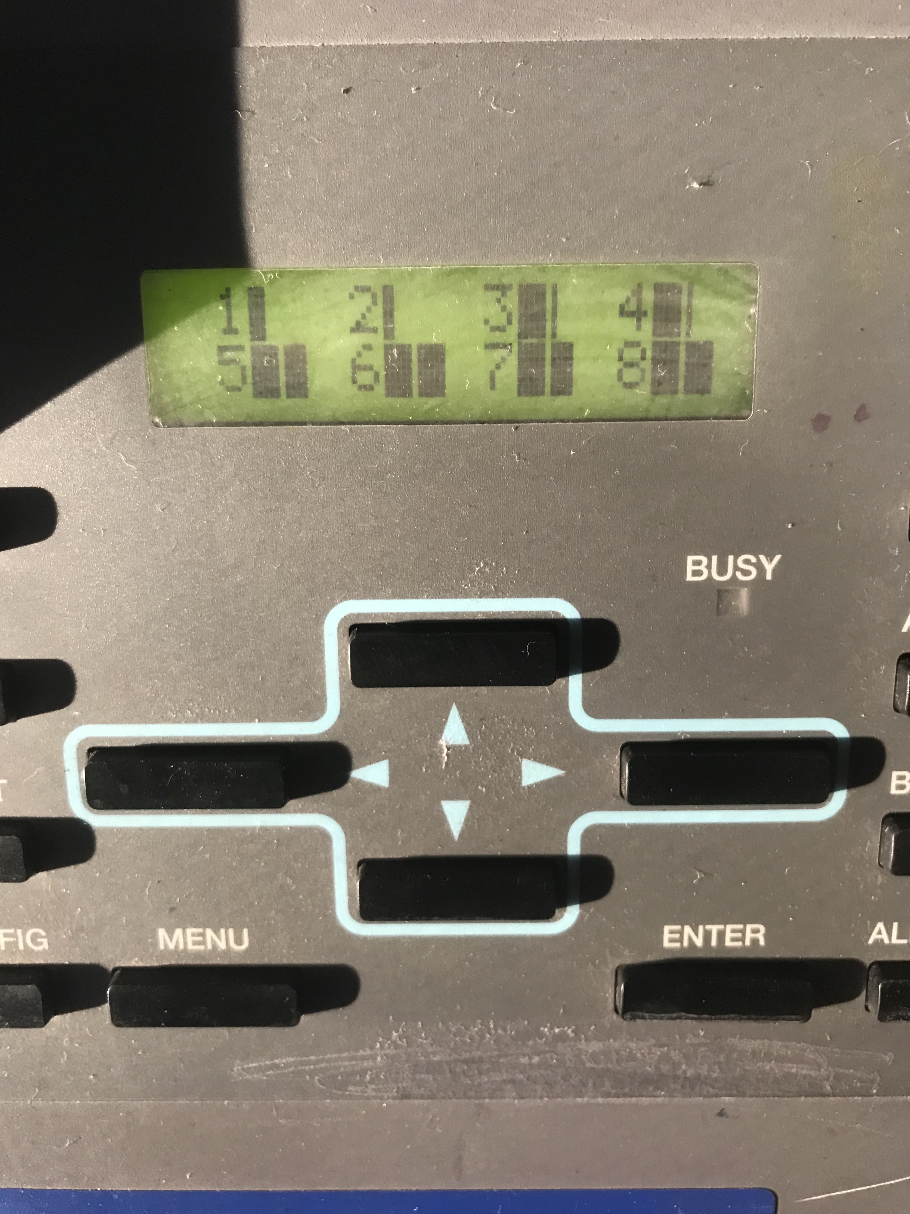

Printer is reading some ink left but if I try to print a test page, no ink comes out. Don’t see any ink flowing.

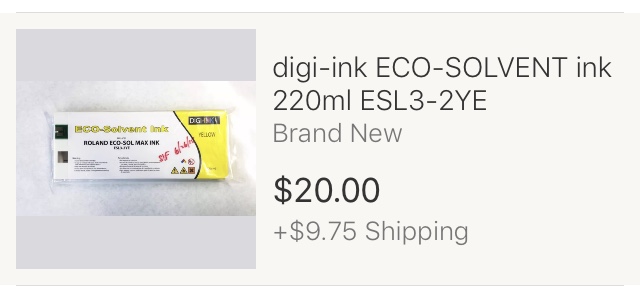

So the holidays are over and I went back to my project. Did some major maintenance and everything turned out fine (major score!). 4 cartridges are empty and need replacement. They are oem 220ml... now my question is, should I buy a knockoff brand since I’m still refurbishing this printer and it’s for testing purposes or should I buy oem to prevent mixing the inks? Any advise and brand/vendor you’d recommend?

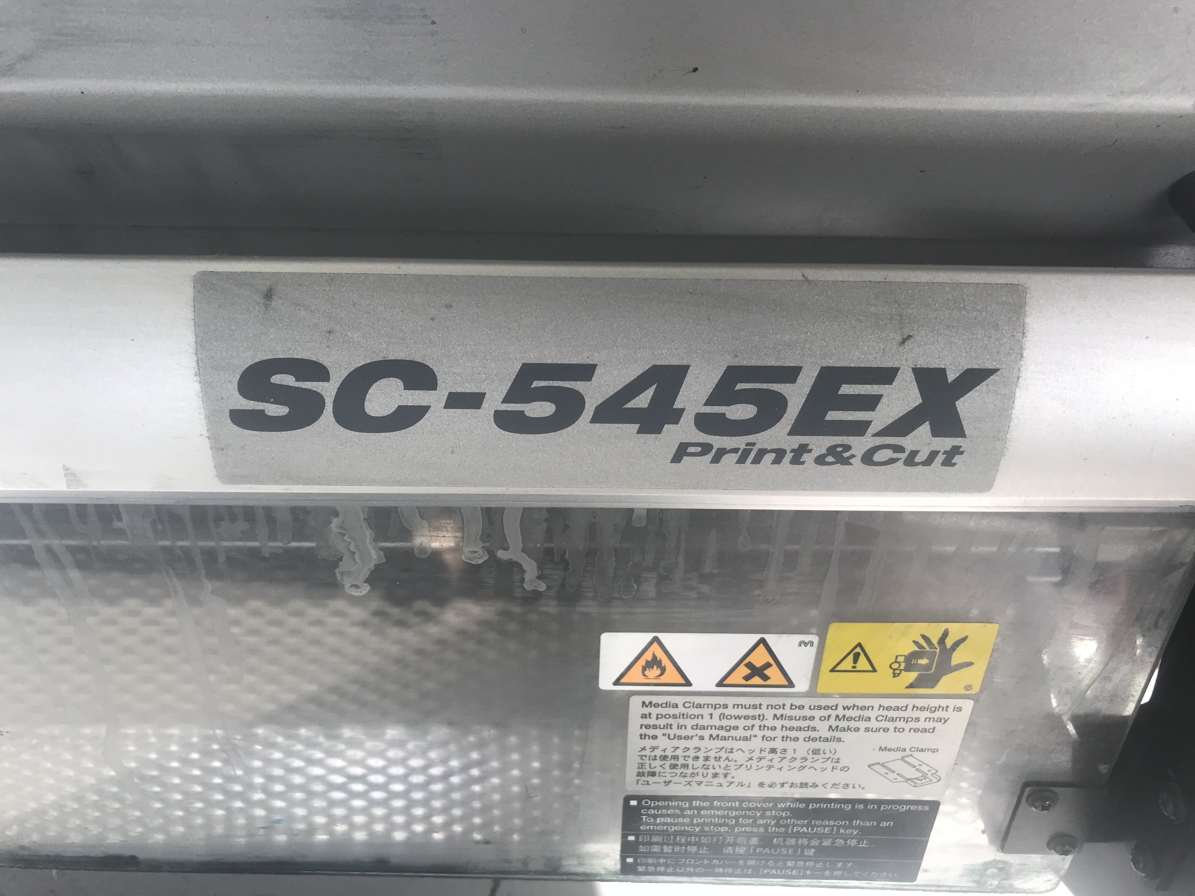

I am converting an SC-540 to an SC-545ex, I have set the dipswitch and installed the newest 545ex firmware. However, I when I try to connect Versaworks says it can't recognize the ink I am using. Are there further steps than this that need to be taken, I know the colors are in different head positions on the 545ex than the 540, my first head is black but I know this is the fourth on an actual 545ex. I joined this site just for this reply on this thread. Thanks for your help, if you can.
Terry01
Will check the dipswitch settings in a couple of days for the 545ex left to right cyan magenta yellow black l/magenta l/cyan
Page 30 on the ex user manual will give you the ink cartridge order but you will need to check the hoses are from those locations to the heads
