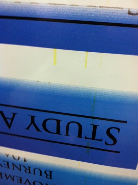

The lines are 1/16" - 1/4" and approx. 3"L N to S, vertical. Usually the same distance from the right hand side. I cleaned the encoder tape real well, it's only 3 months old. I cleaned the carriage board (there was some ink spray on it). The head is about 4 months old.
Any help is appreciated.

Have you turned off the main and sub power?
Did you clean the encoder strip before or after the yellow debacle?
SIGNTIME
thats not an encoder strip issue the encoder strip just lets the printer know where it is left and right if it had something to do with the encoder strip there would be steps in the print. You shouldn't really clean or touch the encoder strip because you are likely to do more damage all it takes is a little scratch.

I found a Verizon router on the same electrical circuit as the printer. I moved it to another outlet. The printer printed w/out yellow streaks for a few hours.I thought problem solved. Streaks came back tonight, I turned off main power, turned it back on and reprinted the same file w/o streaks. I was told by a tech I will have to replace the headboard or head or both. Now, after reading your post I am not sure what needs to be done. Thanks for your input.

Ok, on mine a simple head test is to switch the ribbons from the carriage board to the yellow and what ever color is next to it so cables reach and print to see if lines follow cables to the other head color or not. On mine color switched so is not head but was being sent from the carriage to the heads. Have you replaced any boards? MAKE SURE you turn everything off and unplug first. And yes they did what is right under warranty for him but what do we do without support of any kind. Is there someone we can talk to at Roland? tom

this happens to me once in a while.
in my case, it looks like an intermittent ground in your yellow data cable. my machine will print out something like what you're having now, and might then escalate into a full blown grounded head print. this means that all nozzles of that particular head would be firing for the whole width of the machine.
i was able to fix it by just reseating the corresponding cable [for that head] at the headboard side. that might or might not completely fix the problem. but i did notice that this happens to me pretty much every year. and usually during the rainy season [if not always]. apparently, the increased moisture in the air could trigger this type of problem.

Strange but mine seems to be humidity sensitive some too. Took head board out and cleaned, checked ect and nothing different. I ran a ground wire through the black chain from frame by head board to carriage and it seems to help but still few random lines. Few months ago I switched the long cables from head board to carriage board but didnt fix so I dont think its the long cable? Any Roland repair men that know how to help us? Sometimes it seems to be fixed only to reappear. What are the symptoms of a bad head board? tom:banghead:

The problem is getting worse. It' s starting to look like majenta head before I replaced it. Like I said it is 4 months old I bought it from Solvent Ink Jet in Denver Co. The head should be good, I purchased a black and cyan head from them and its been fine for a year now. Any thoughts? Thanks
