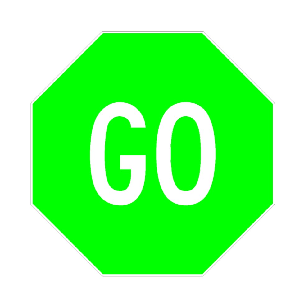

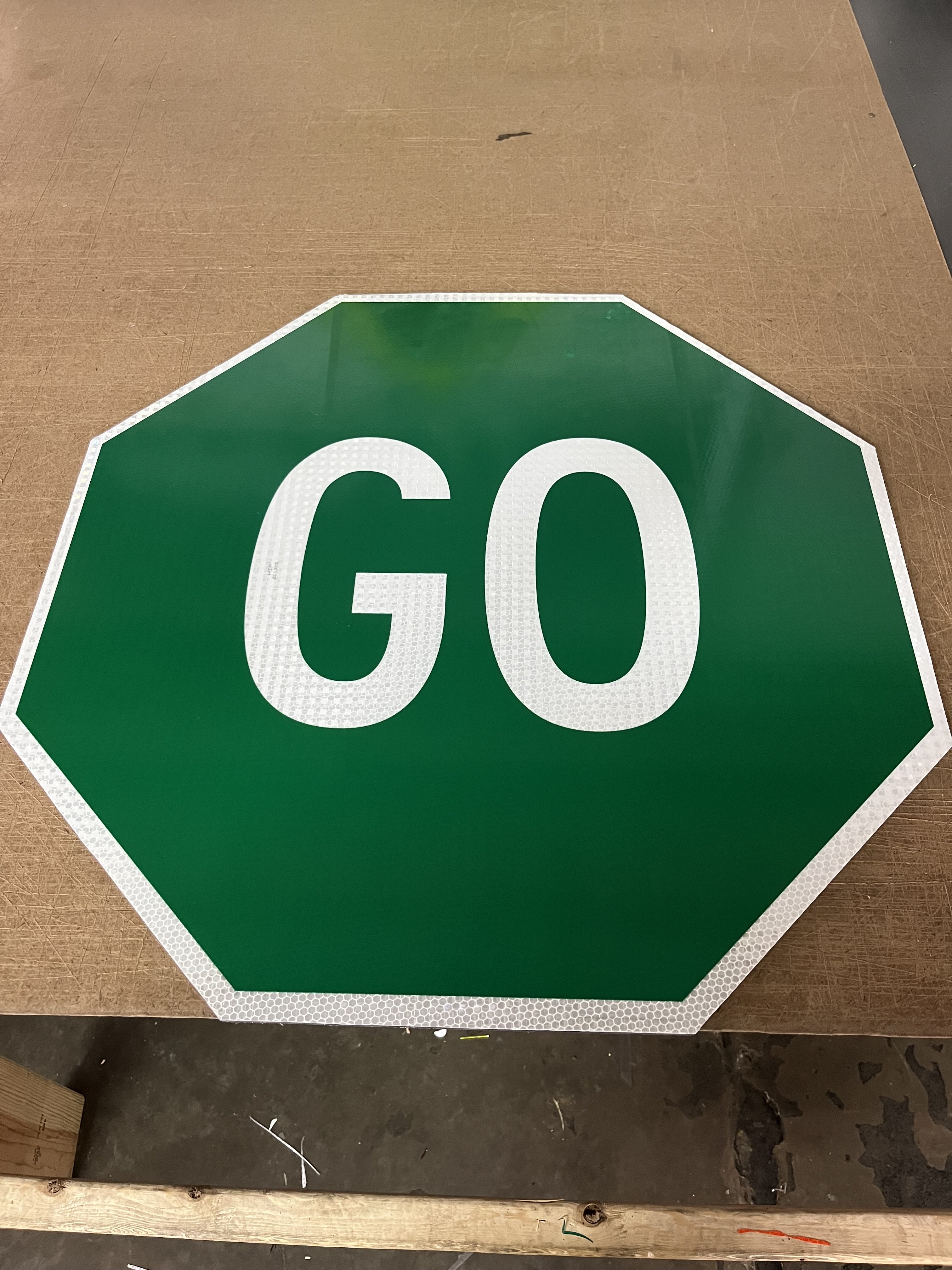

I recently got a Roland VG3 Printer. I am using to print signage off of reflective vinyls and print decals. Every time I use Flexi's Rip and Print to print, it will print darker colors than intended. I have VersaWorks install on my computer and it prints more accurately just a little lighter than the color it was sent to the Queue A category on VersaWorks. Is there a way to get FlexiSign to print the correct colors on my Roland Printer. If not, could VersaWorks print the correct colors going to change something in the color settings?
On the left is the image that the color was intended to print on FlexiSign. Right is what color the printer printed.

First off, you'll never get the green that shows up on my screen to print off of a CMYK printer. So proper expectations need to be set.
Second, you're opening up Pandora's box of color management here - we can't fully answer this question in this forum. Roland Versaworks has a lot of profiles for their printers available on RolandProfileCenter.com. You'll probably find something that's acceptable on there.
Flexi will allow you to get there, but there aren't as many profiles available, so you'll likely have to create your own. Fortunately, Flexi has the software built into it, unfortunately, you need 1. to get a spectrophotometer and 2. learn how to properly create ICC profiles. Find someone to teach you for that last one, it's worth the money spent.

IndySignPro
