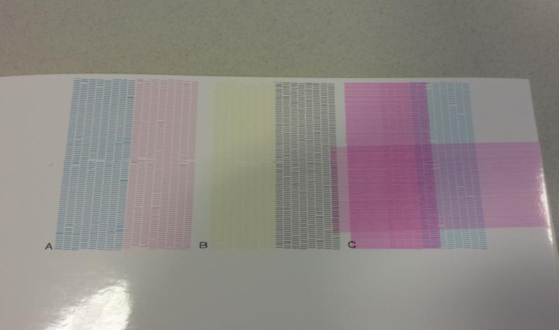

I can't even find this problem listed anywhere on the web. We just typically use our printer for making stickers to put on resale vehicles.
Everything was working good last Friday but now we turned it on monday and this test print shot out.
Shutting everything off I can unplug the left bank of this head and the other half prints fine. So just half the head is firing whenever it wants apparently.
The odd part is the weird scratch lines happen on the first pass. It doesn't do it when it moves over and runs the second set.
Here is what I tried - multiple cleanings, cable swaps, damper swaps.
It's getting ink - it's just printing when it's not suppose to.
Solventinkjet
DIY Printer Fixing Guide
When you did the cable swap did the problem move or stay in the same channel? If it moved, you most likely have a bad cable or the main board is fried. If the issue stayed in the same place, your head is most likely dead.

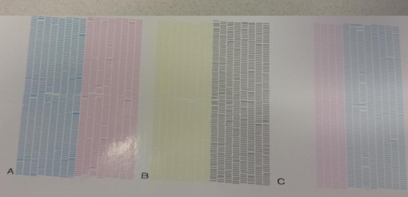

Here is another copy
As you can see - if I turned the printer completely off and unplug the half side of the head - it prints fine with no problems with ink across the paper.
Well - we thought about doing that after we unplugged the cable and found the half head causing the problem. When we tried swapping the cables last night it popped the f2 fuse. We figured this had something to do with the ranking history and programming. Replaced the fuse and going to round 8 with this thing.
Just got done completely cleaning everything.
I am just wondering if half the head went screwy. The other half prints perfect!.
