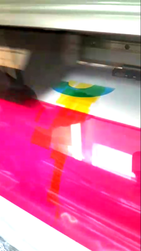

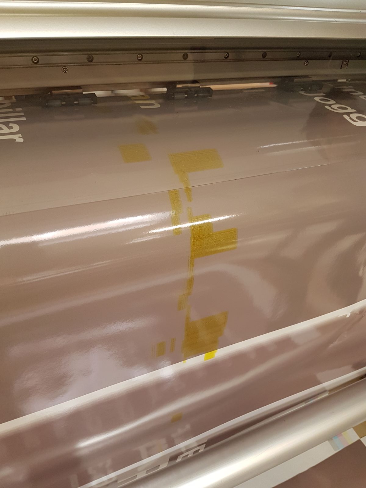

I have printing issue with a RS-640 (see pictures attached and video link :
The yellow print artefact is always located on the middle of the width of the rs640.

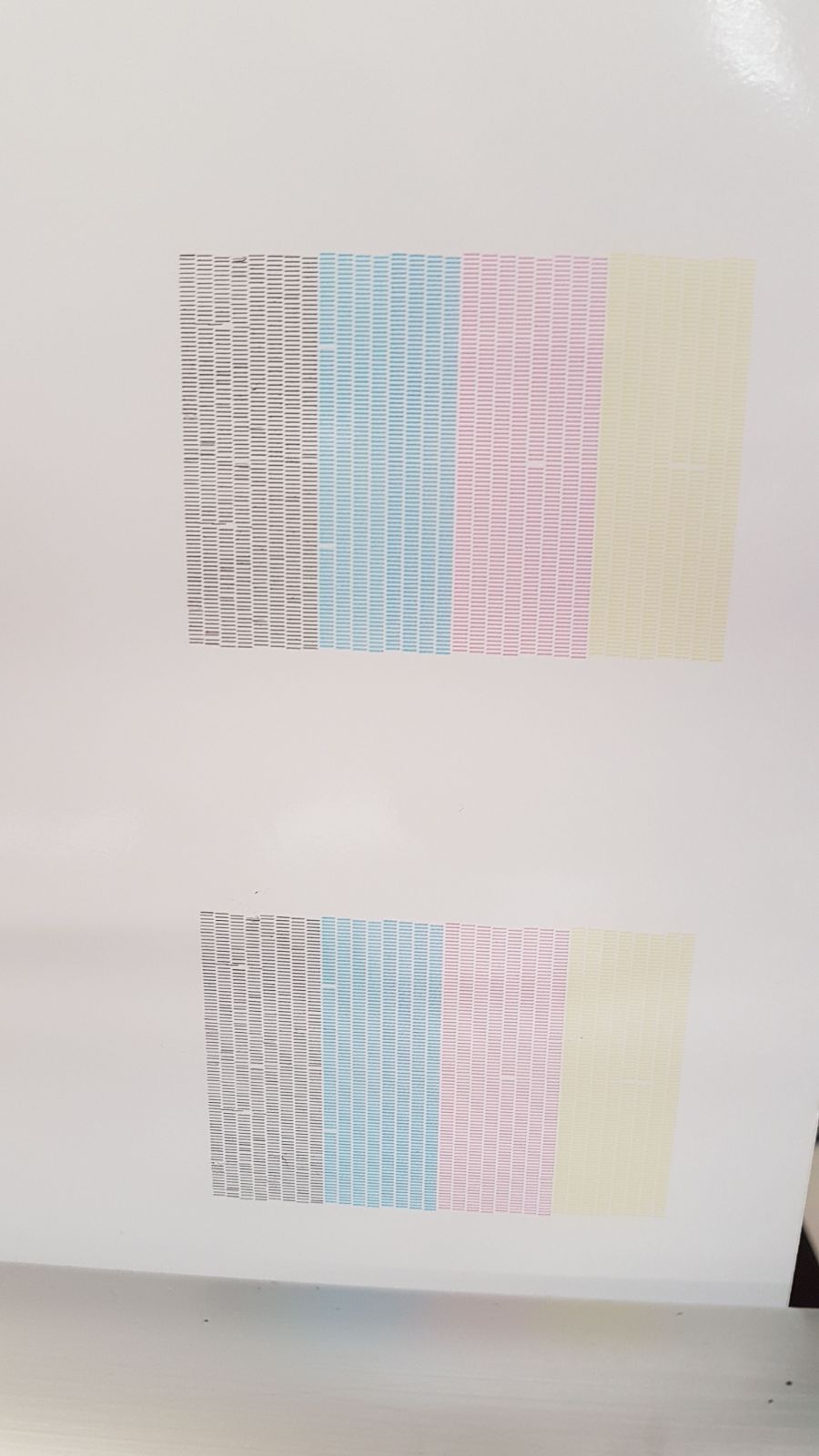

After seeing the issue, we printed a print test > head ok (black one should be cleaned but it is not the case).
We also send the demo file from Versaworks and we got the same printing issue with yellow.
It looks like electrical problem with yellow head flat cable scratched or damaged.
Any advise?

If you're lucky it's the data cable. You could change it with a new one, and see if the problem stays or no. If it stays switch yellow head with magenta, see if the problem travels or stays on yellow. If it stays you're outa luck, main board needs change. Hope this helps
yerffoeg
Thank you for your reply Triggerhappy!
I had a call with Roland support this morning, they confirm what you said.
They are pretty sure that is the data cable from mainboard to carriage board.
I ordered the cable and will replace it today or tomorrow.
I'll know the results asap.

I am lucky cause it was effectively the cable in cause of the problem.
Now it is fixed.
