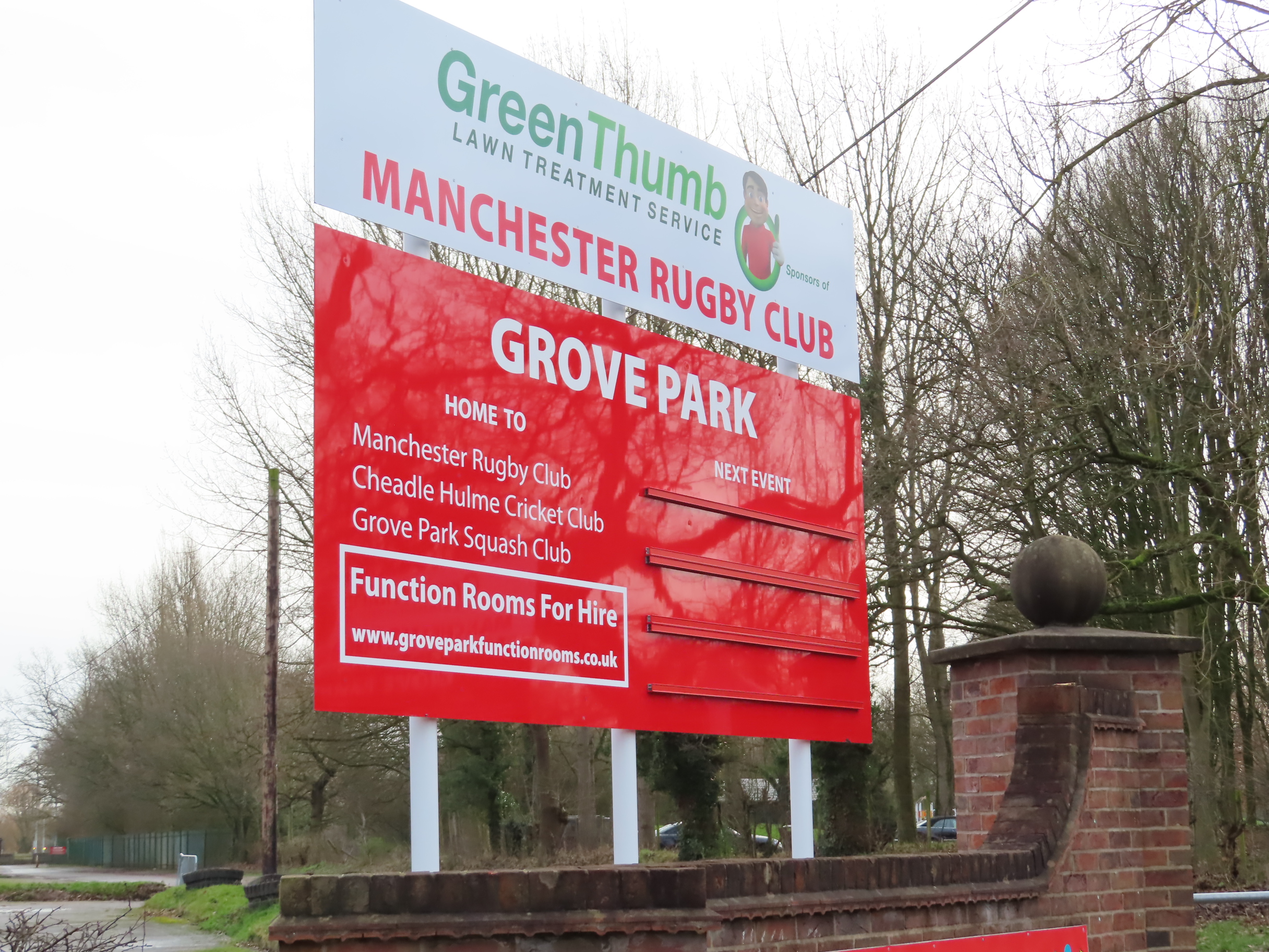

We make them for Rugby Clubs etc we just use sign rail that you would put on the back of panel and post signs and rivit this to the face, the channel formed is ideal for sliding dibond / foamex panels in and out of. wouldn't be too difficult to attach padlock or but and bolt to the ends to prevent removal
That is a great idea, thanks for that I am going to give it a try!
