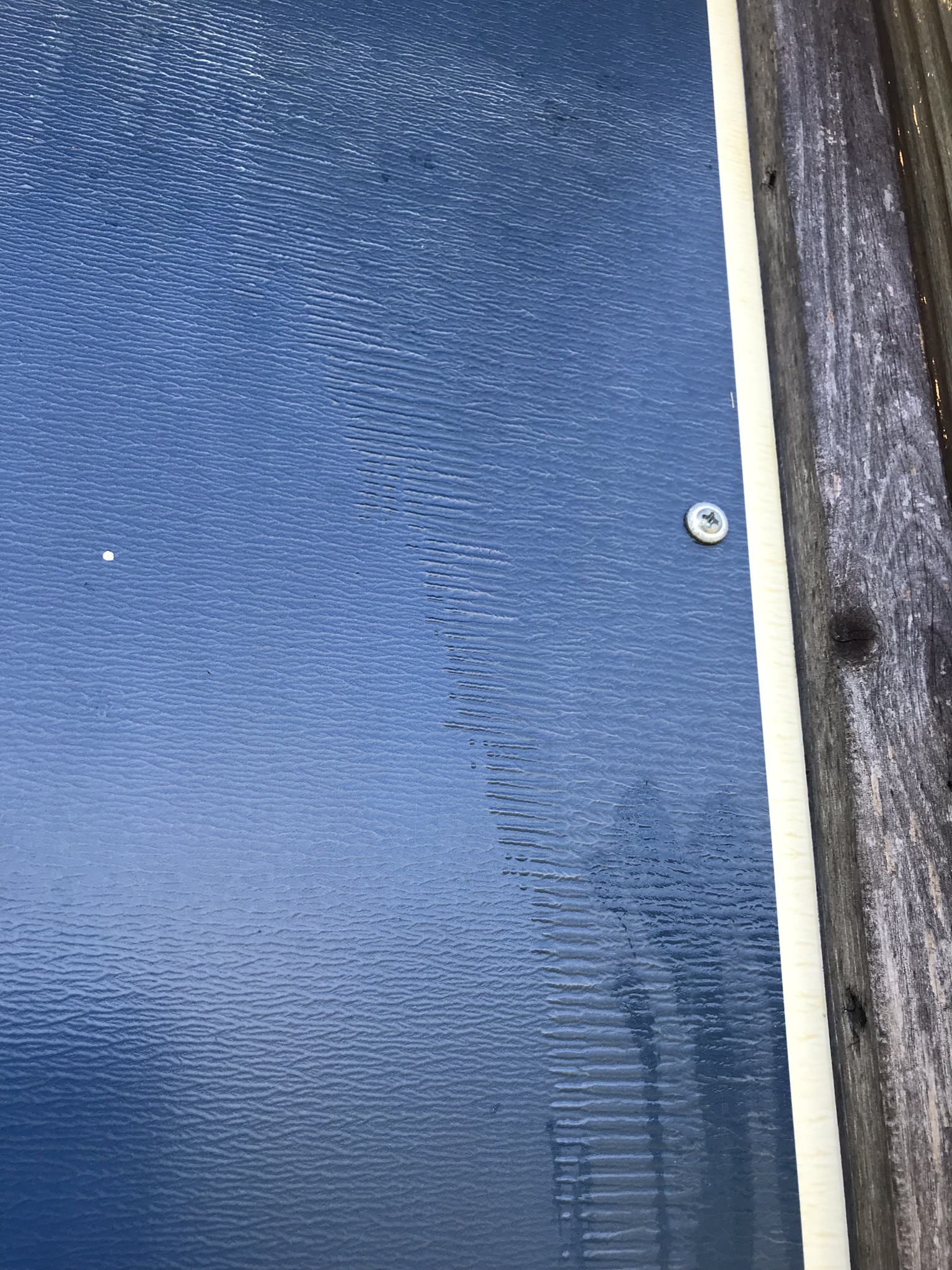

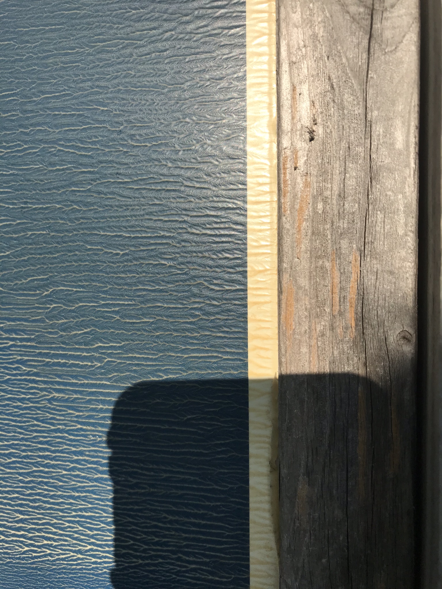

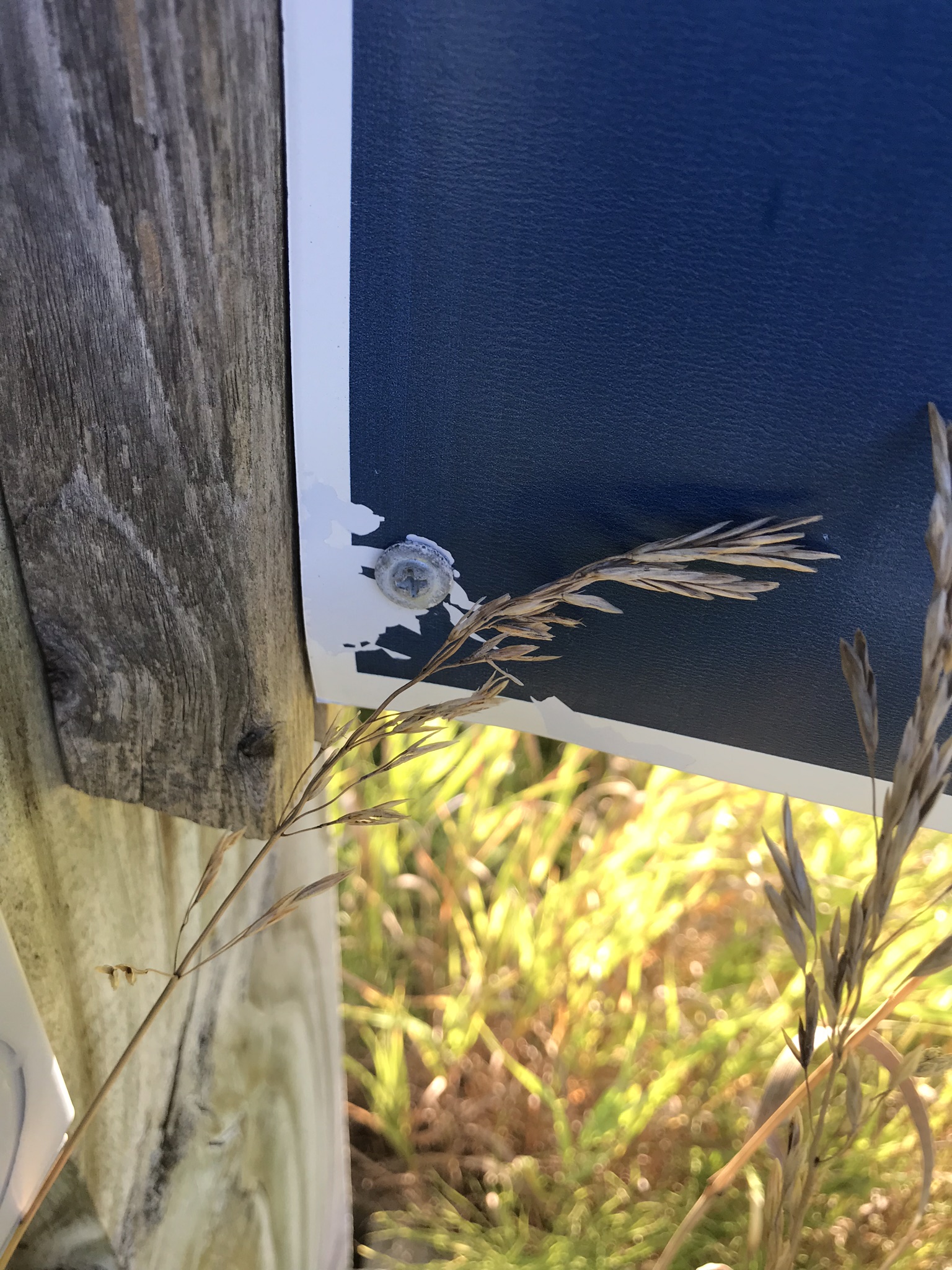

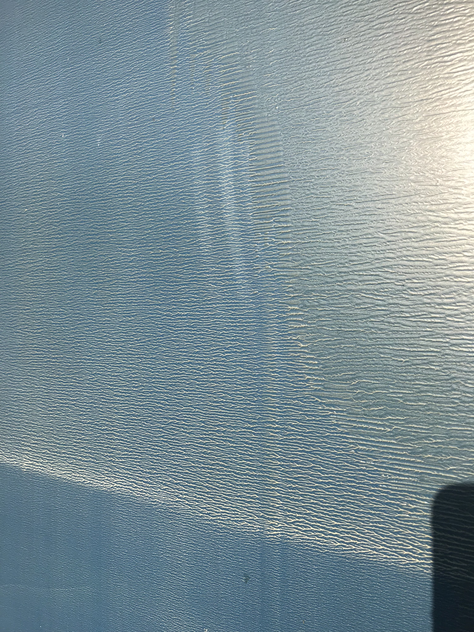

I did not print or install this sign. 2 - 4'x8' sign boards screwed over the top of an existing plywood sign. This customer came to me in Spring looking for an estimate and must have found it cheaper elsewhere. This sign was installed around April-May this year. It is direct printed onto a 3mil material, perhaps acrylic? Looks like it was rolled up and unrolled to install as it's curling on the edges. I had an opportunity to crawl through the weeds and take these pics as I would like to be able to tell him what failed if he wants the sign replaced. He is a good customer of mine for other signs and t-shirts. It's unfortunate because the sign looked great when they first installed it. Soon after I noticed a horizontal line on both sides of the sign where it appeared to be faded. I thought it may have been a shadow but it's not. What might have gone wrong with this? Thank you!

The way it's turned under on the picture with the blade of grass waving around, it doesn't look like any rigid substrate. It appears the ink is having some sorta reaction to whatever it's on. Almost like it's being cooked off. Have never seen inks blister like that. Do both sides look alike as far as the problem ?? Can one side be facing due south ??

Looks like a polystyrene (? I think) sign that we bought from home depot and is doing the same thing but has less coverage. Like the ink hit the surface but never bit in.

Gino - one side faces East the other West, both sides are the same. The horizontal line is in the same spot on both sides. All summer when I drove past I thought my eyes were playing tricks on me, was it a shadow? Was it dirty? No, it is neither of those once I was close up. Both signs must've been printed and laminated at the same time to cause this on both sides. Above the sign there is a small roof that sticks out about 18" so the shadow thing made little sense to me when I would drive past early in the day or late in the day. Had to get out and inspect! Was driving me nuts! LOL

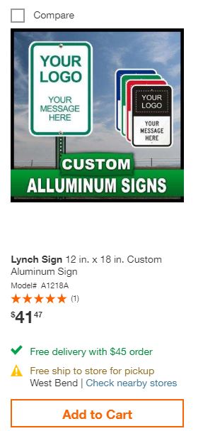

I had no idea you could buy signs from the Home Depot. I just looked on their site...the word "aLLuminum" is spelled wrong on all the aluminum signage LOL

Liquid lamination issue 100 percent. they ran this thru the machine twice as the roller was set to high the first time. The laminate fused and dried better on the ink than it did on the material used. Also I have see this happen when The liquid lamination is put down before and after printing like a sandwich
Not really sure what happened to that, especially if it's flatbed printed.
