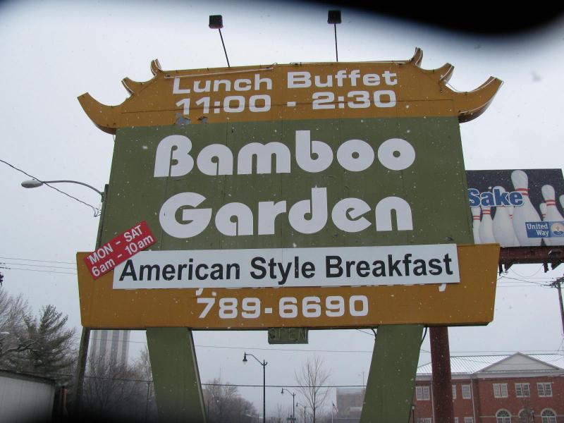

Any suggestions for any brand of exterior paint to go on existing metal sign? Ive attached the pic of existing. I will need to paint the top and bottom brown sections of the sign.. its some sort of metal.. doesnt feel like aluminum but doesnt feel like steel. I dont know what it is. And the brand of paint needs to be able to be color matched to the yellow max metal panels.
client wants a hodge podge sign consisting of max metal panels covering 8' sections.. which leaves about 4' on each side. He is foreign and doesnt want to spend money.. so there is a communication barrier on two levels.
Basically I will be painting the exposed brown sections that the yellow 8' panels wont cover. They ask.. I just do what they want when theres no getting through to them.

At first, I thought it was covered in guano, but then I realized it was snowing. :Big Laugh
Do you realize, you have to practically scrape and get ALL of the old paint off, before you prime and top coat it ?? Otherwise, it will continue peeling and you'll be the blame.
You also have neon all around. Are you going to remove that in order to paint ??
Once you scrape it and have it clean a a good oil-based primer on the metal should work and I'd use an industrial grade oil-based paint from any of your local paint stores.
Most likely, it's galvanized, so ask at your local store what they have and can recommend in stock.

I assume they won't fix the neon so make sure the electric service to the neon is cut off-permanently.
If it's rusty spot prime with POR15, if it's not then what Gino said.

I like Ronan's Speednamel, but it may not come in those poopy looking colors.
Maybe just regular old Rustoleum enamel.

your post makes more questions that cant be answered untill you get a littlemore clear on what your talking about!!!! WE SEE THE EXISTING SIGN. how tall and how wide is it? iam guessing its 2 sided. this makes no sense to me:
please clarify your intentions here. your talking MAX METAL? put it over the existing sign? why yellow panels? where did they come into the job?
IF A MAGNET STICKS TO IT, its STEEL, if it dont ITS ALUMINUM. IF ITS GALVANIZED, you will see that. NEED MO INFO.

Wow bunch of people thinks pass ...lol lol just to funny ... easy job for me do it all day long
Latex will work fine ....Scrap, light sanding, clean, paint with quality latex Primer where necessary ...Paint with good quality latex color, letter with same, UV clear coat if pay or job is worth it.
