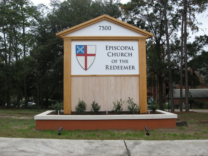

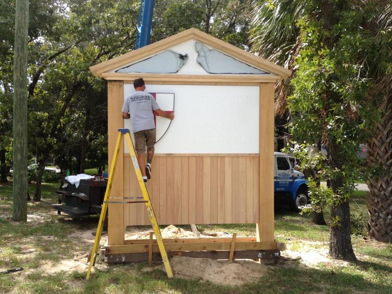

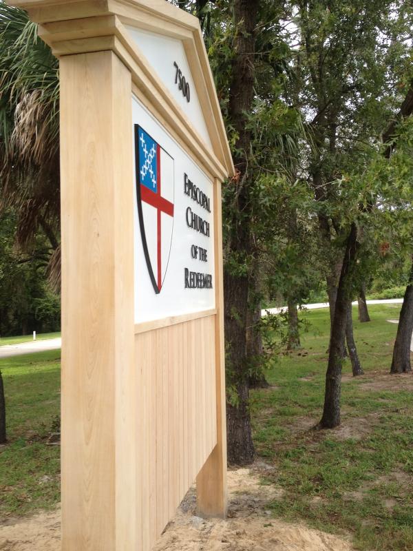

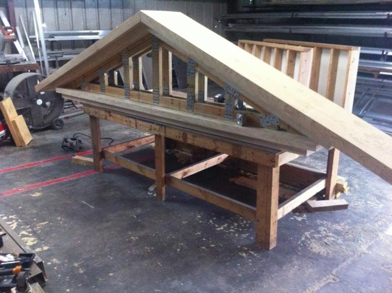

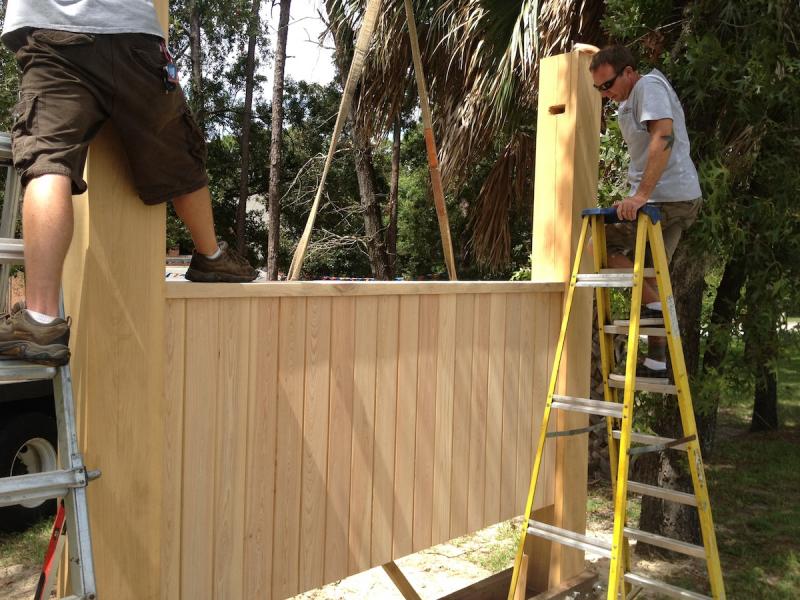

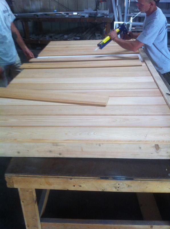

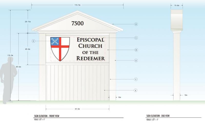

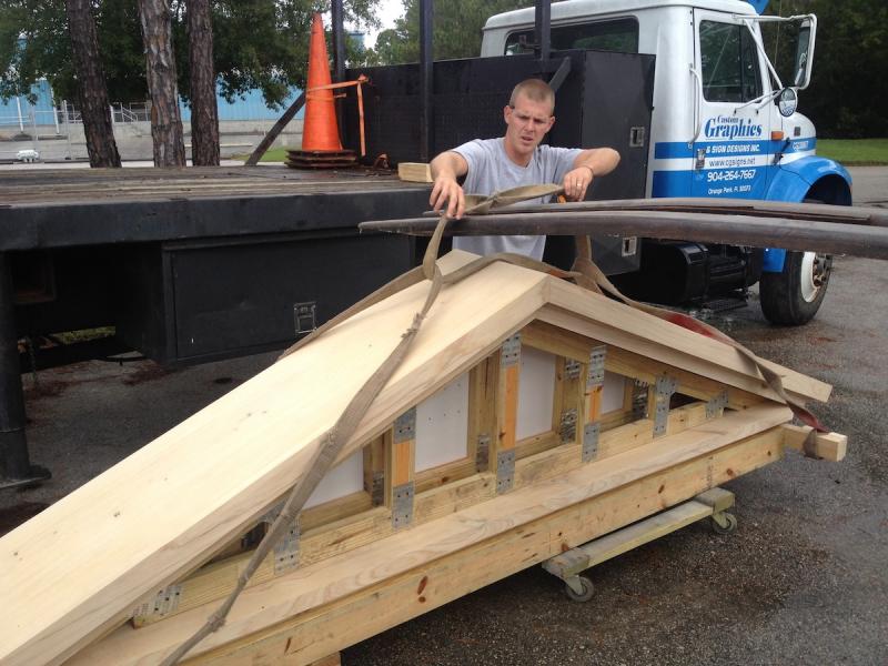

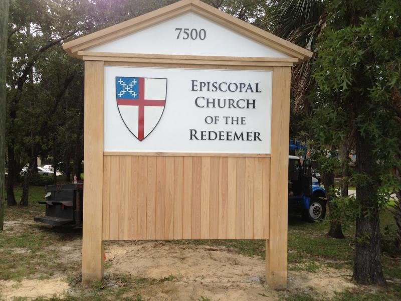

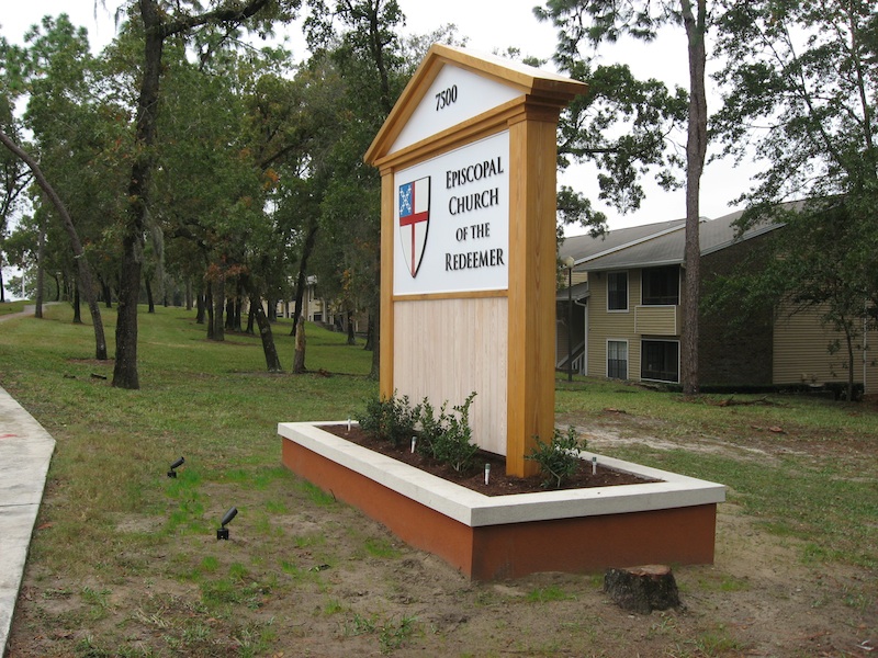

We recently finished constructing a new monument sign for a local church. We decided to build this one entirely out of solid cyprus with MDO faces and Aluminum letters.
The posts are solid 10" x 10" cyprus. The top is made of multiple layers of solid cyprus. This sign is HEAVY.
Here are some photos of the production and installation. We still need to add the brick base/planter and the white wash stain.
Unfortunately the layout on the face isn't nearly as nice as the structure that holds it all together! (Design by committee)
