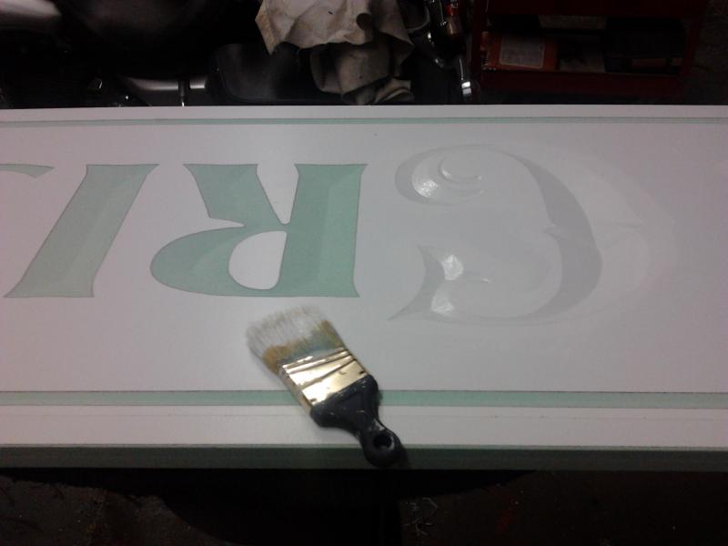

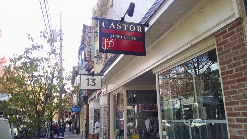

All 18lb sign foam whittled on the shopbot and painted with ronan aquacote

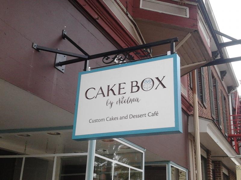

love the cake box sign. did you design this? it is simple yet not so simple all rolled into one. love the detailing in the letter "O"

I really like the Cakebox. It seems like a fairly simple sign, but the crisp layout and mounting details gives it an elegant deliciousness. :thumb:

Oh yes very nice eye candy indeed even some detail under the arches & good solid looking mounts to.
Thanks Craig
We made the brackets in house out of alum and sent them out to get powdercoated

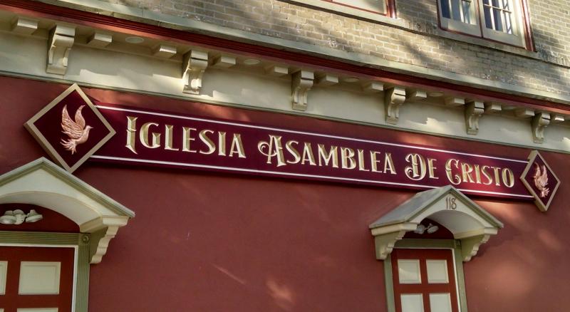

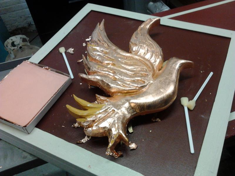

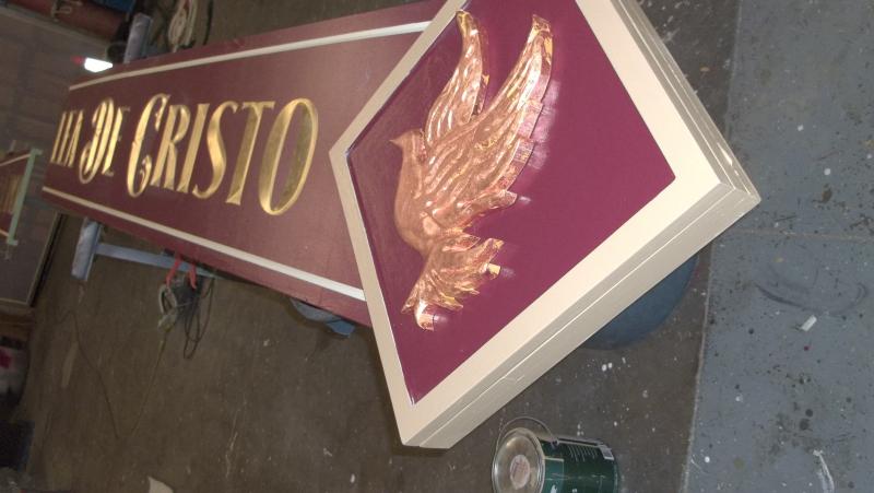

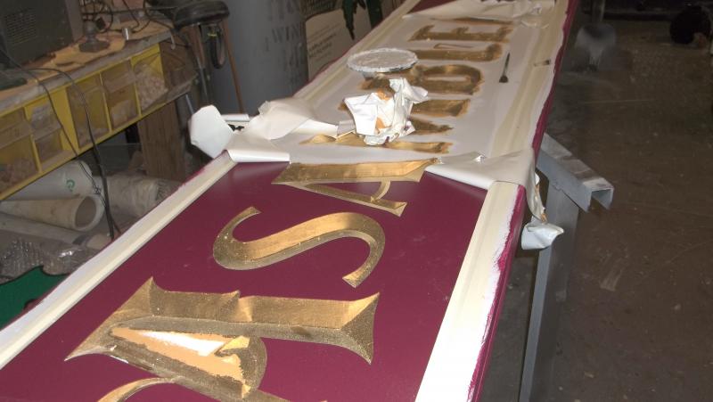

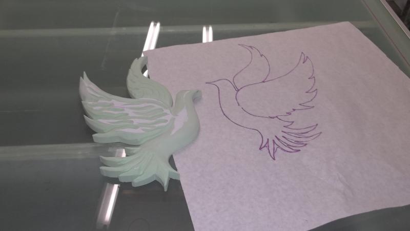

I like the Spanish church sign. Any more info on it? I'd like to see more pictures of the doves. Also, is it gilded?
Doves were hand sculpted.Lettering is gold leaf.Doves are copper leaf cleared with permalac

Cake box was there logo we just turned it into a sign.White space rules
