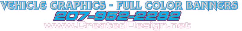

I am printing the attached lettering. I have made a cut around the letters. Send it to Versaworks, It prints fine, when It cuts, the cut lines are off by quite a bit .25'' . It seems as though the substrate must be moving. Any tips on keeping this straight. The image size is about 60'' by 12''
Thanks
Eric

I've tried aligning the print/cut on the sp540v. I have tried slowing down the cut speed, adjusting the offset, and the pressure.
I have tried printing and cutting a small "test" lettering and it is off by about an 1/8th of an inch . The cut outline is off to the right of the lettering when finished. So basically on a black font I have a white drop shadow so to speak.
