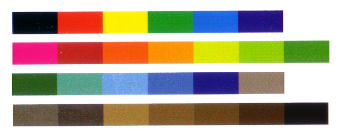

I have been able to improve the colours by increasing the density and ink limits (although I think that changes the colour too) in rasterlink. Primary colours usually look fine, cyan always coming last in quality. This is not an issue when doing a large print but when printing a business card size sticker it doesn't look so great.
I have attached a sample print that is enlarged. Is this a standard result for a wide format inkjet printer or should I be able to get smoother colours?

If you change your ink limits you will change the appearance of colors. It will pretty much ruin the profile.
As far as the "speckles" go: All process colors are made up of little dots of individual colors supplied by the ink set dispersed proportionally to blend together into the ultimate desired color. The distribution of these dots when run in low quality modes such as 360X360 dpi is coarser and will makes the "speckled" effect more pronounced. Are you trying to use a profile for banner material on adhesive backed vinyl? Are you running the head high or low? The effect you are describing is in essence a byproduct of how inkjet printers work, it just seems excessively pronounced in your case, but I'm guessing its a configuration/profile issue.
Make sure your doing something like 720X720 8pass with variable droplet size and have adequate heat on the media to make it receptive to ink. You need to use a profile that is built around these parameters too, not just change the pass count and res of an existing profile.
